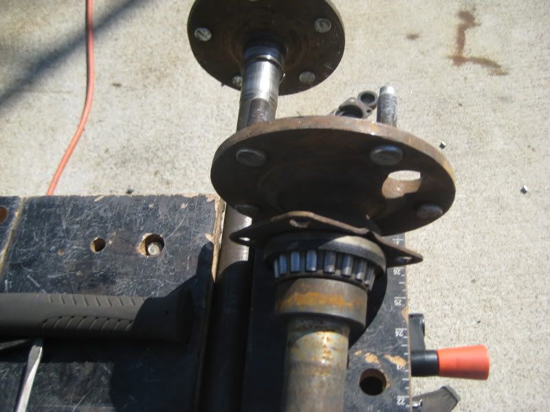

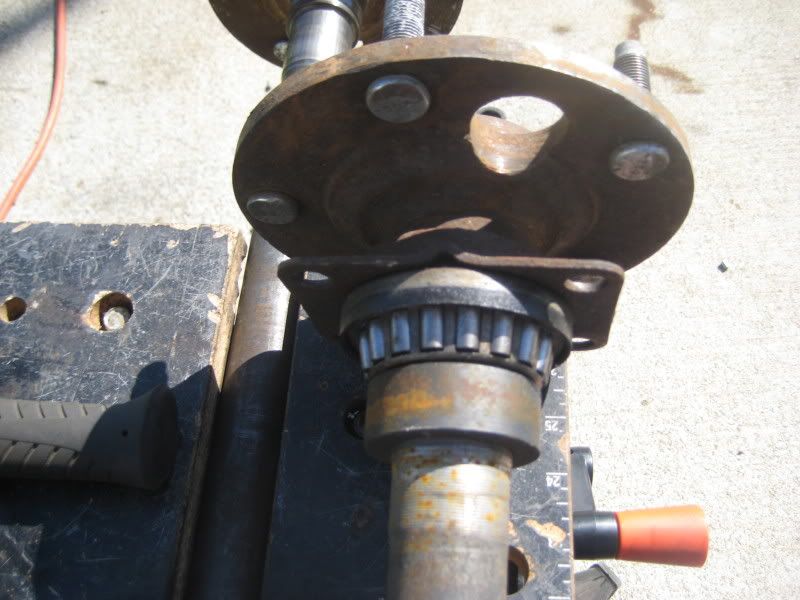

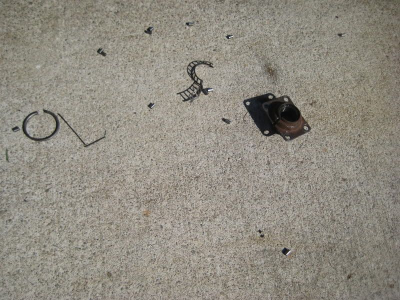

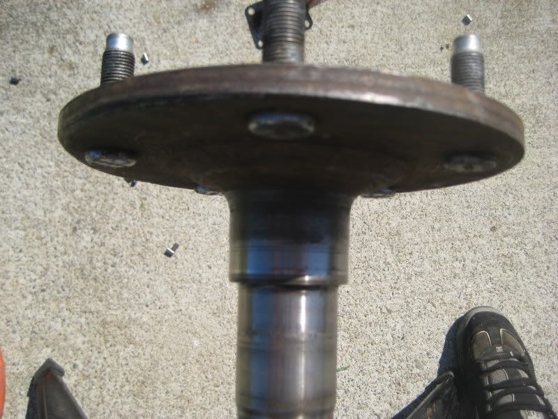

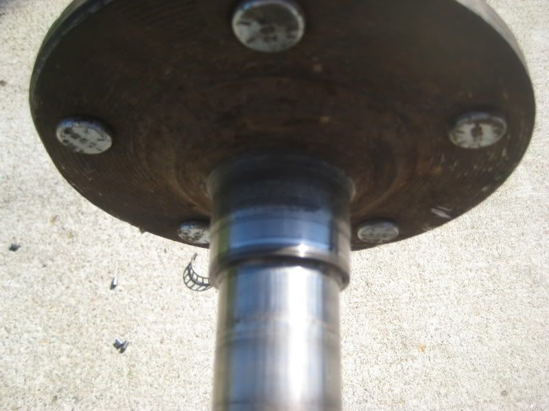

I got 2 spare 9" shafts from Ryan who got them from Cesar who got them from me (funny how that worked out huh?). So I cut the bearings off to put on new ones.
Getting them off was super easy, took less than 5 minutes per axle. Just used a cutting wheel on a grinder, a hammer and a chisel. These shafts are my spares, my plan was to get new bearings on these, put em in and use the shafts in the truck as spares.
Important note to anyone considering cutting off wheel bearings: Notice in the first 2 pictures there is a backing plate with 4 holes in it, this backing plate holds the seals and bearings in place on the axle, but I DID NOT need to resue them because my disk brake kit elminates these piece. This is important because it wouldve been very hard to cut off the bearings without destroying this backing plate.

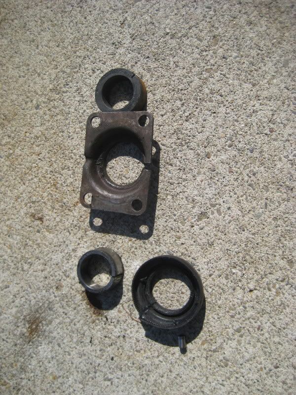

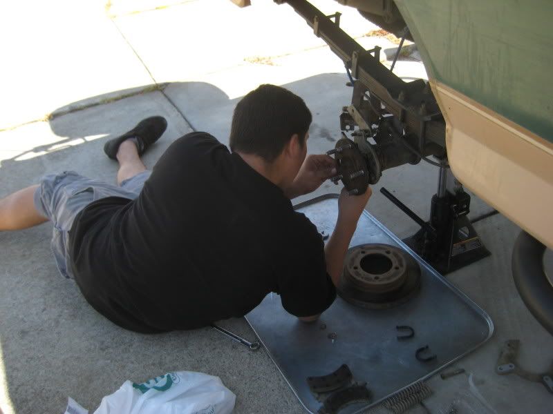

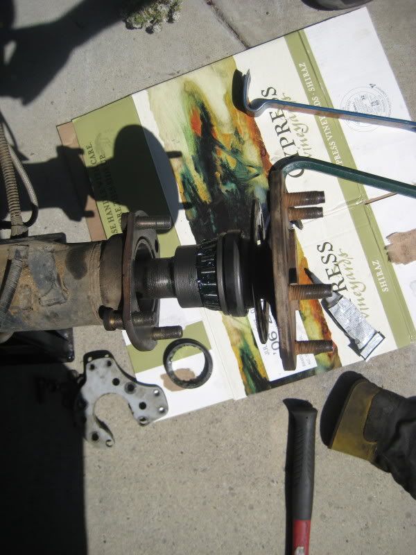

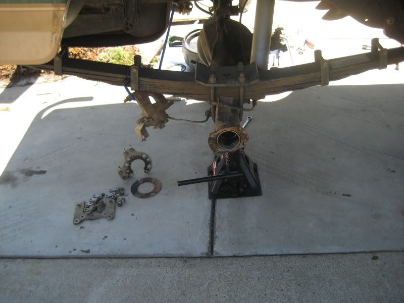

Took it apart
So this is where my good progress stopped. As it came time to put the new bearings on I was prepared to try the hammer on method prescribed by Dave and Scott. I got the bearing on with a lot of effort, but the retainer just wasnt happening. These things supposedly have .001" tolerance so its a tight F**n fit. After a lot of hammering I decided to cut my losses and put it back together with the olds shafts and seals.

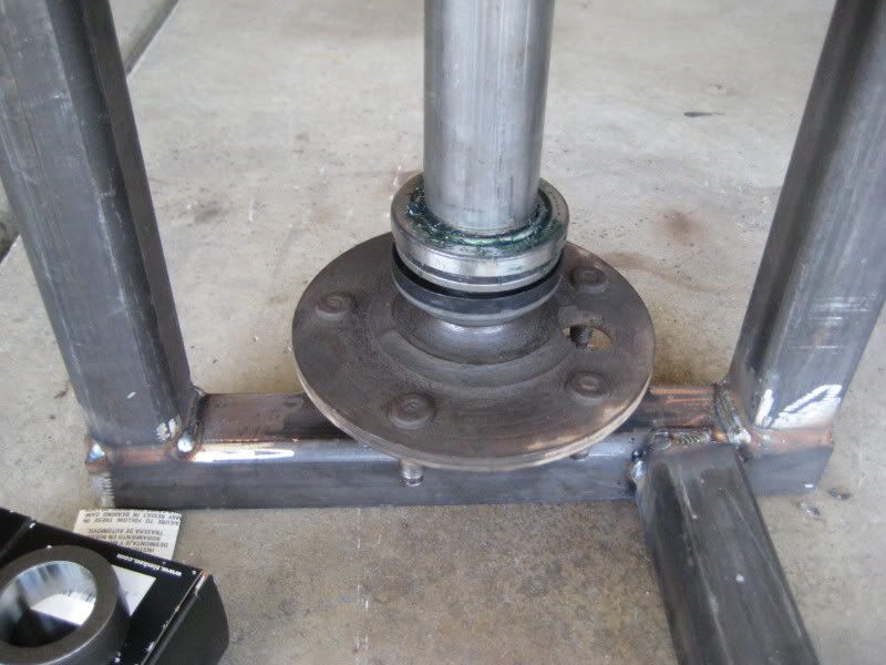

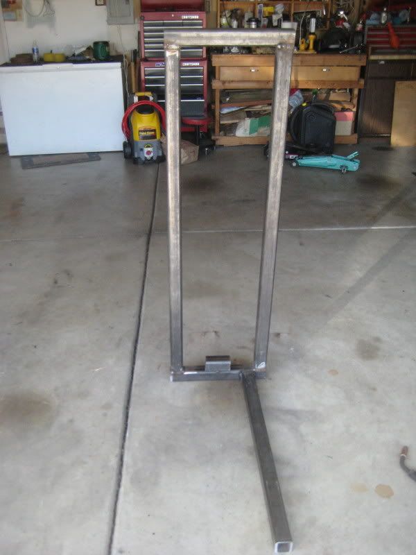

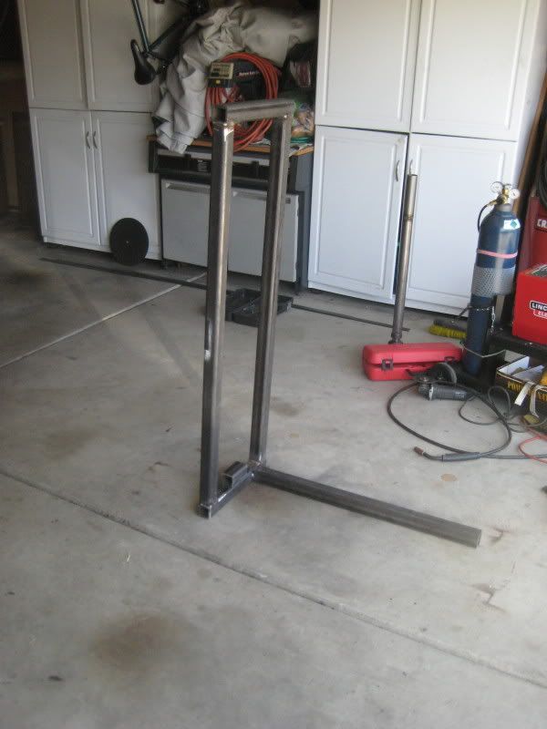

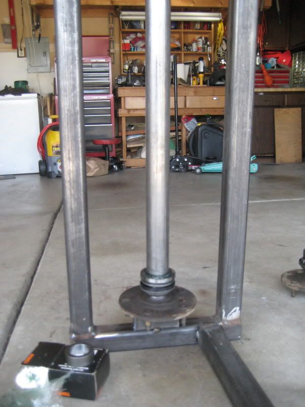

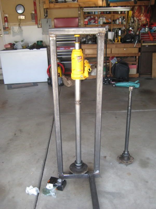

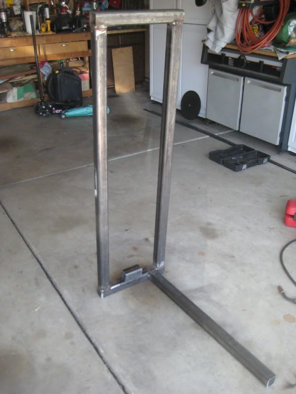

So I had the week to think about it and with Dave out of town (only person I know with a press) I decided I would build one. Started with a bunch of 2x2 .250 square tubing I had in the garage and a piece of 2" round .120 wall DOM tubing. I was also lucky enough to have Ryan come help me today so we cranked this out.

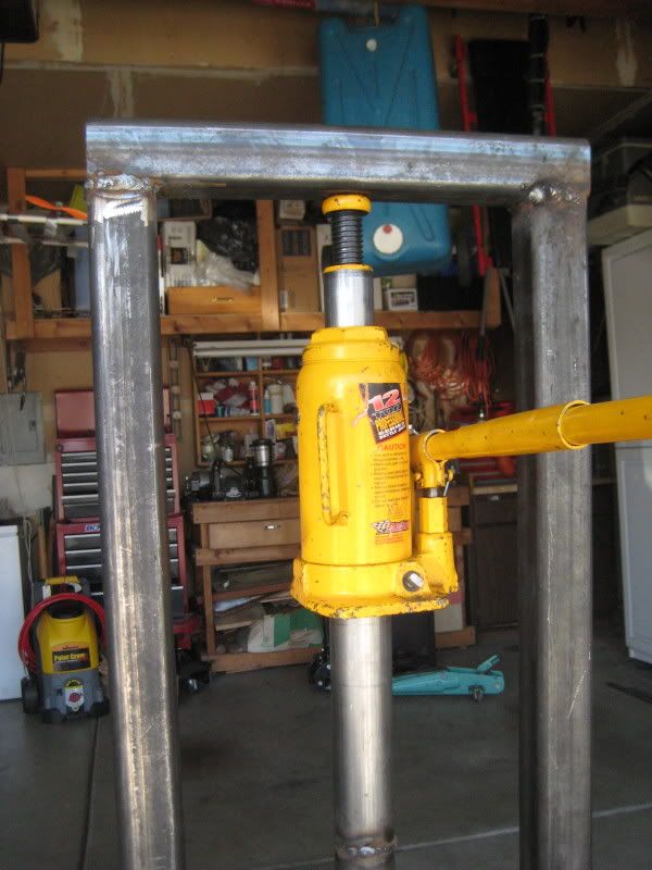

So I built this thing and was feeling pretty stoked that it would work. Borrowed my dads 12 ton bottle jack, put the shaft in with the bearings and BAM it slid right on like butter. The retainers proved to be a little more effort, I was damn near maxing out the bottle jack and there was like 18 metric shit tons of pressure on this thing but it slowly pushed them down. Pushing the last retainer on when it bottomed out the round tubing bent and came flying out and the whole jig fell over and parts went flying everywhere. Fortunately nothing broke and everyone got out of the way of the shrapnel.
So at this point I was feeling pretty damn good that my home made press had gotten the job done. So Ryan and I cranked on it and had the whole thing back together in like 2 hours with a lunch break. Thanks Ryan for your help I greatly appreciate it.

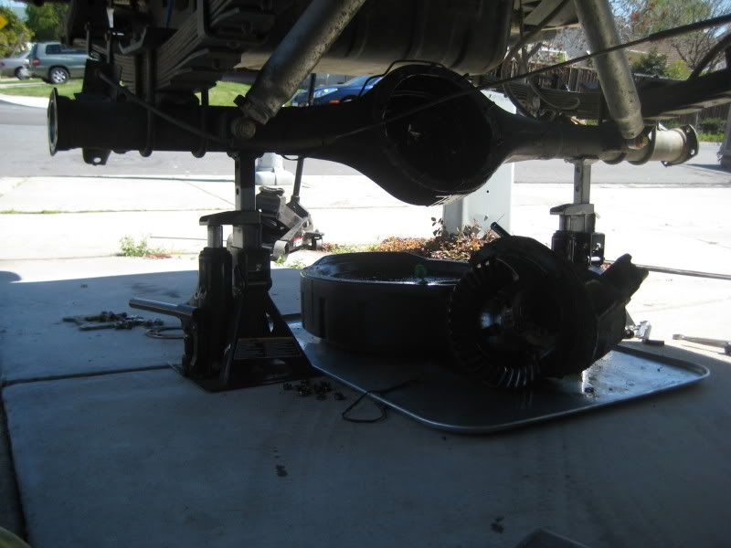

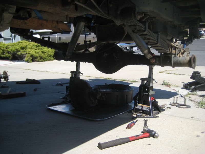

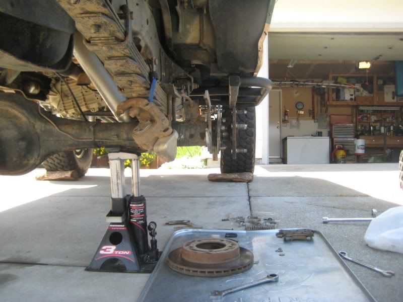

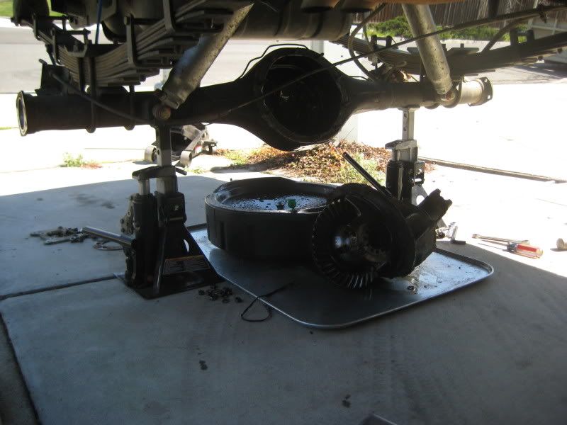

When the third member was out I inspected it thoroughly and the gears look to be in perfect condition, the pattern looks good (had some left over paint) and the backlash feels good (I dont have a gauge to measure). I had forgotten how stout that Strange 3rd member was! The whole assembly probably weights like 75-80 lbs its heavy!
The press was welded together with MIG. I expected it would hold but it was kinda cool confirmation to see the 110volt MIG welds to hold up to 24,000 lbs of force. The bottle jack put a good dent in the top support where it was digging in, and thats impressive considering it was 2x2 .250" square tubing, I mean this shit is stout. Basically there is a rediculous amount of force on these things... Made me appreciate the amount of power these little bottle jacks have.

Glad you mentioned the disc brakes, I was confused why you would want to by that retainer again.
In you last shot there, did you grease your oil lubed bearings?

And the bearings were greased pretty heavily out of the box, but they also have gear oil all the way out to the edges there that they are constantly rolling in, so its not like the grease on them is their only source of lube.
