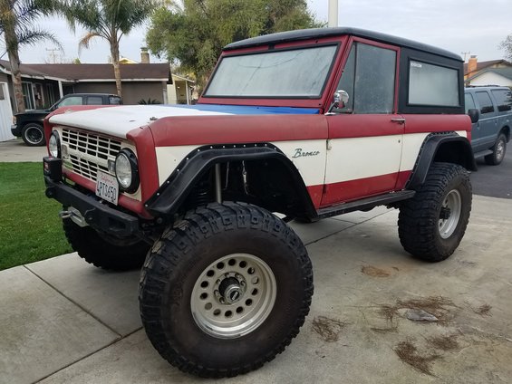

The bronco got brought out a couple of times for some off-road testing/fun. I realized I was uncomfortable with the doors and top on mainly because of my size and how hot it got. I sold the top and the doors and bought a set of half doors from wild horses. I'm currently working on getting a custom soft top made and i'll be swapping out my "rice rocket" seats for the corbeau's I had in the race bronco. I stopped trying to make the bronco into a daily driver on 40's and decided to put my time and energy into using it on some trips.
I installed a "lunch box locker" in the front axle, installed a new rear diff cover from ruff stuff and I also got my spare tire carrier / bumper sorted out. The 5:1 Atlas rocks and makes this bronco more like a unstoppable monster. I was only able to stall it once while in 100:1 and that was with all 4 tires bound up at the same time.
I also had to trim quite a bit of sheet metal from the back and I still have more to go on the front but so far my suspension and wheel/tire combo has been spot on for the build. I'd like to get beadlocks soon but i'm pretty sure that isn't going to happen until I get some new tires.
I'm currently adding hydro assist as well as a fuel line vent system as those were the two biggest issues I ran into while running slick rock last month. I also replaced my alternator which crapped out on me and left a 1/4 mile shy of getting on my trailer.

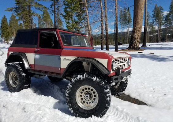

Some trip pics
File comment: Snow wheeling to uncle toms march 2018

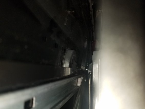

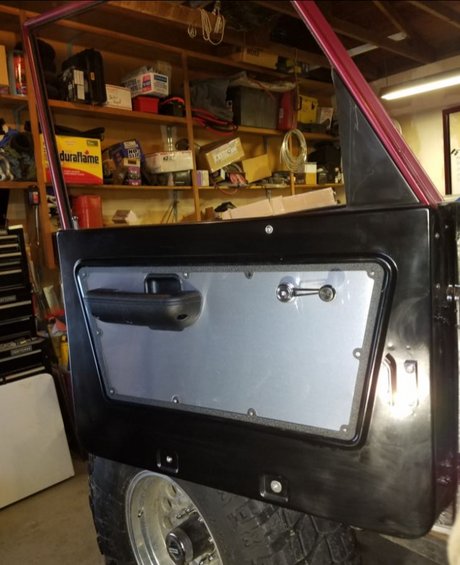

about a year and a half ago I bought tube doors off of wild horses along with their S.S. hinge kit.
These are great because they are powdercoated and have a nice arm rest built into them.
Then, about a 4 months ago, I decided I wanted doors again but this time, I would build them the way I wanted them.
instead of going the wing window route, I went for the one piece kit. I have always felt cramped in my bronco being a taller, larger guy and these windows rolled down compared to my old wing windows makes it seem a lot less stuffy. Everything went together great and when I had a question about the install Mike was really quick to get back to me.

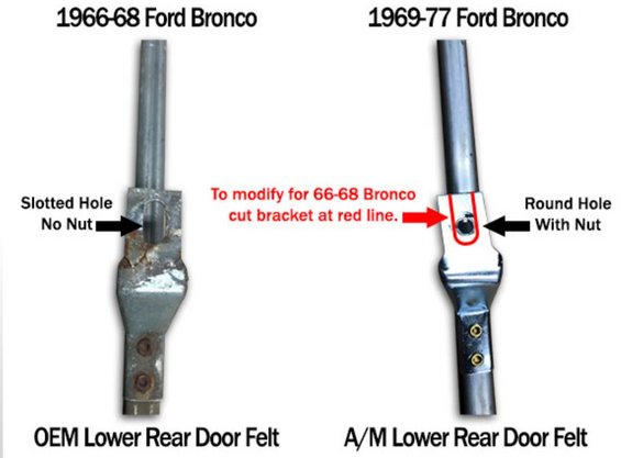

If building doors from scratch (not modifying previously working window doors), You will want to order up the lower bumper and bracket, lower window felt track which needs to be modified to fit around the upper window frame bolt and window cranks. I'll post the link to those
https://www.wildhorses4x4.com/product/One-Piece-Door-Window-Kit-68-77-only/Early_Bronco_windows
https://www.wildhorses4x4.com/product/Rear_Window_Track_Left_Door/Early_Bronco_Weather_Stripping
https://www.wildhorses4x4.com/product/Rear_Window_Track_Right_Door/Early_Bronco_Weather_Stripping
2X https://www.wildhorses4x4.com/product/Window-Stop-Bracket-66-77/Early_Bronco_windows
2X https://www.wildhorses4x4.com/product/Lower_Door_Glass_Bumper/Bronco_Door_Parts_68-77
https://www.wildhorses4x4.com/product/Window_Crank_w_knob_Import_w_Black_Knob_6877yr/Bronco_Door_Parts_68-77

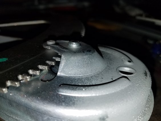

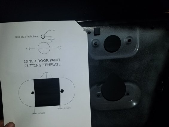

How to modify the tracks if doing what i did
On the doors, both of these need to be cut out for the window weather strip to fit in place. I used a cutting wheel and a new blade to cut them out

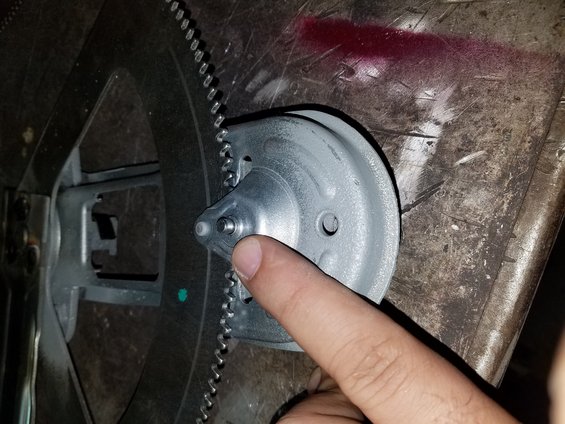

Then you have to make room for the different regulator. It sits flat so you have to remove the recess and drill a hole for the top mount.

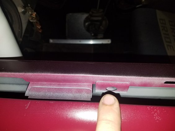

Only "customizing" I had to do was on the driver side I had this nub interfere with the window going all the way up and I had to take a flapper wheel to it to keep it from making contact
finished product
forgive the lack of paint work (made this trip a lot nicer with the windows up)
Old door set up looked like

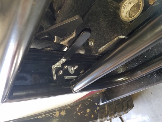

And Hydro assist steering. I had sent my box out to redneck ram place in texas and had them do the full rebuild, port and tap for hydro. I also purchased their ram kit which was great. I opted to get a linkage mount from chassis unlimited as I wasn't confident in my ability to get it right the first time. I ended up making a cylinder stop out of flat washers and nylon washers. I was told it wasn't necessary because once you max out the pump it will bypass the fluid so it doesn't self destruct. I like it on there as an insurance policy.

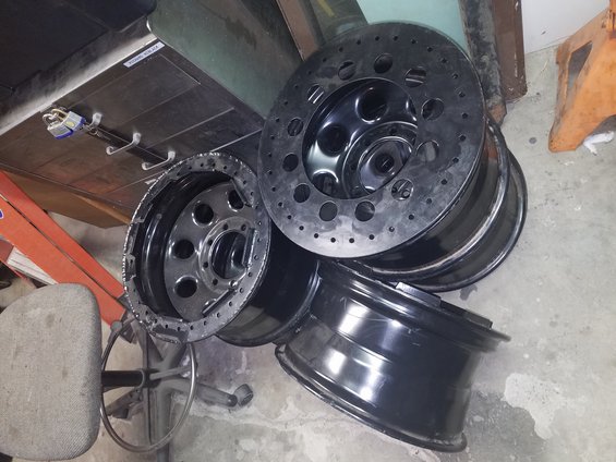

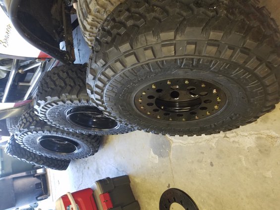

I just went through a new wheel and tire debacle with me trying out a different back spacing. I bought a set of 17" beadlocks off of craigslist for steal of a deal. DIY beadlocks that had already been welded and were powder coated black. they ended up being 3.5" back spacing which I didn't realize was going to be such an issue for a couple of reasons. Mostly because it would cause new clearance issues on the front tires rubbing the front bumper, fender flares and fenders while flexing. Also, I could no longer load the bronco on my trailer without fabricating drive over fenders of modifying them some other way. As it is now I have removable fenders but I can drive between them when I don't feel like pulling a fender off. The third reason is the increased chance of getting pulled over for tires sticking out past the fenders and not running mud flaps. I refuse to mount mud flaps so I need to keep it as close to legal as possible.
40-13.5R17 nitto trail grapplers
mounted with the rings painted the red the bronco is supposed to be

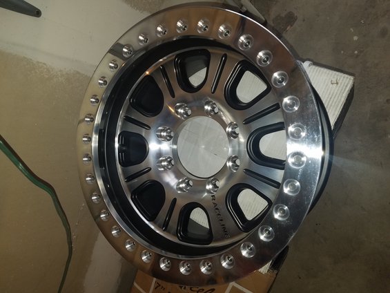

Luckily I was able to sell them for what I had into putting them together which gave me a "redo" and so I have gone the other way with the back spacing. I went to 5.5" back spacing on a set of raceline monster RT232 17x8.5
To be mounted when I can buy tires again. cash in hand from the sale of the wheels went towards soft top and doors build so I could go snow wheeling.
