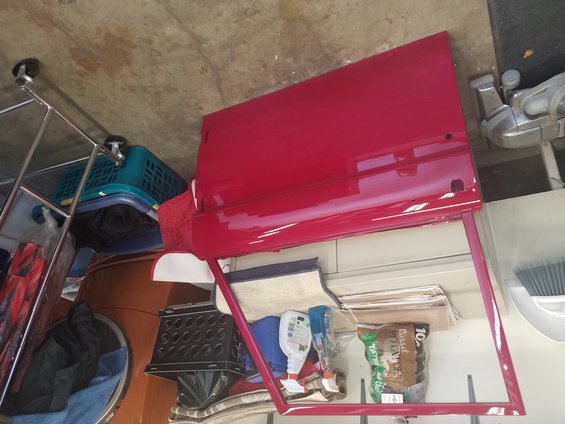

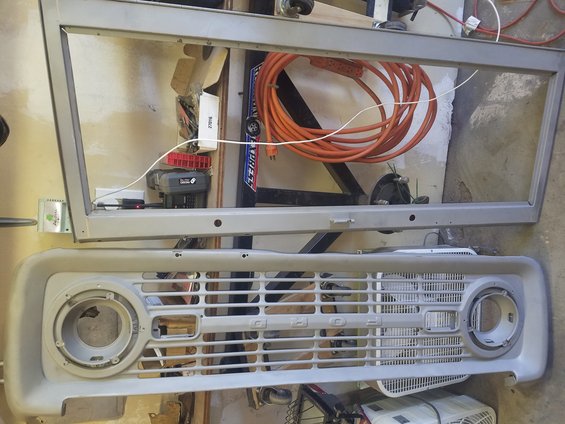

Like with everything with this bronco... this next project snowballed into a massive project.
It started when I finished my doors and threw some paint on them from the same can my initial paint job had. A nice dark red and off white... as you can see, Krylon faded pretty bad..
So then I talked to my neighbor who's been painting fenders and hood as a hobby to see if he would be interested in painting the bronco and he was ecstatic. With a thought in my head about how much it was going to cost in paint materials (huge mistake), I started the tear down..

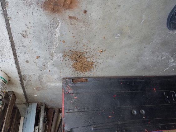

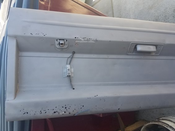

First parts came off were the doors which I had just finished assembling.... had to tear those all down which was a bummer as it all was just put together and working perfectly. Then came the tailgate...I didn't realize how rough it was...

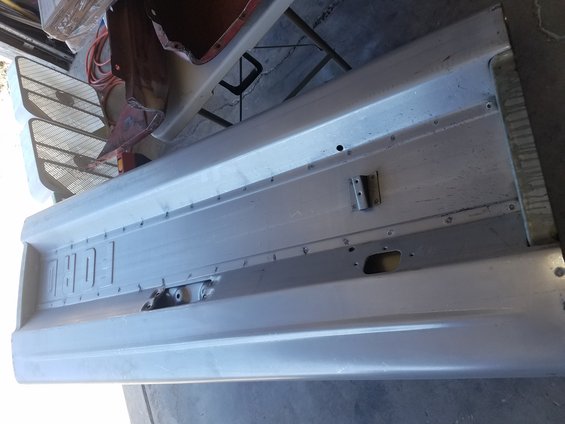

Got it sand blasted..
So I bought a new one of those....
Then came the hood which was a hand me down from "weldnmn" which is ok but not good enough for a nice paint job. It had tares and repairs in it plus the hood pins were way off from each other (don't drink and install hood pins)
Then there was the windshield frame which was good from afar... but far from good. Tons of extra screw holes, rusted out windshield hold down bolt area and bent pretty bad...
sand blasted with the grill
I patched it up, welded all the holes up and then had to literally jump up and down on it to straighten it out. Not too bad now.

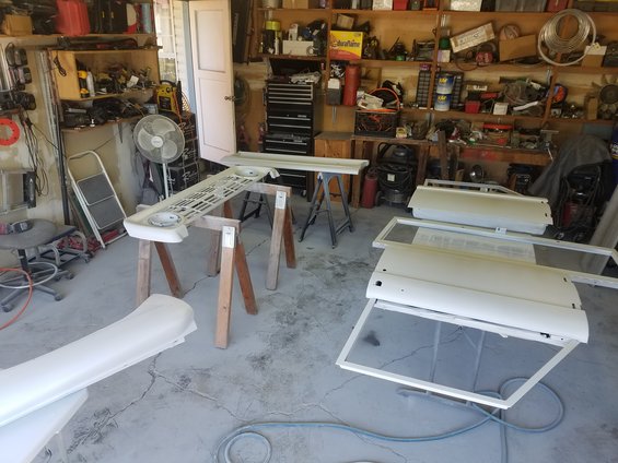

Then the fenders which I have cut and moved metal around on for the elongated wheelbase. They are rough front and back so these will probably be the parts that show how much I suck at body work the most....

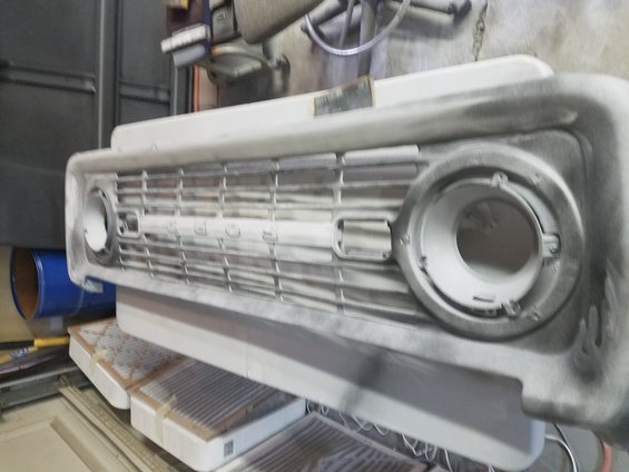

The grill is good shape but it has a lot of voids and contours to sand so this sanding took about 5 hours...

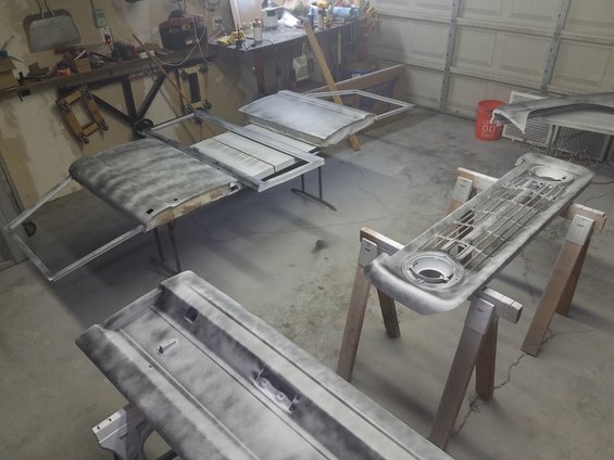

All laid out for primer....

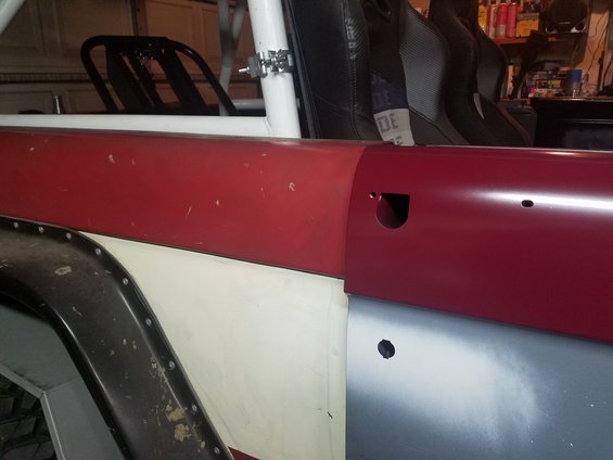

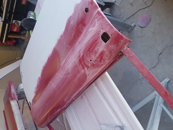

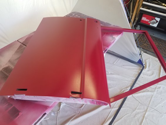

This is where the story sucks a little. As I was block sanding I would sometimes sand down to bare metal and when I did that I would touch it up with a can of primer I had on the shelf that was a bit darker than the primer we sprayed initially... Not knowing this was going to be a problem, the first door was painted and the spots where I touched it up showed like blotchy spots. Set that one aside to dry so it would be sanded and redone later, my neighbor re-primed the other door and gave it a lite sanding. He then painted it and he found out that you can't lite sand filler primer.... it needs to be blocked. So both doors needed to be sanded back down, re-primed, block sanded again and then painted... again. Luckily the doors are easier to sand and paint and we didn't do the whole truck at once like I wanted to.
Finally the doors were ready for paint so we gave it another try... finally great success.....

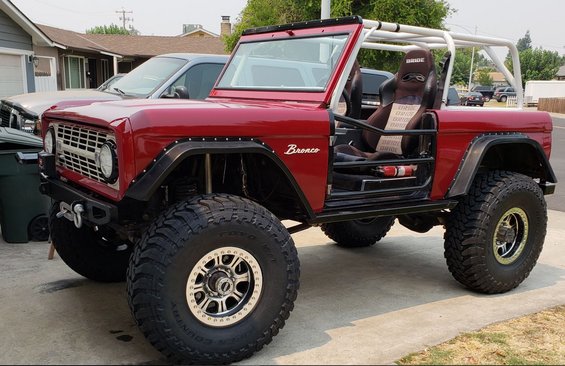

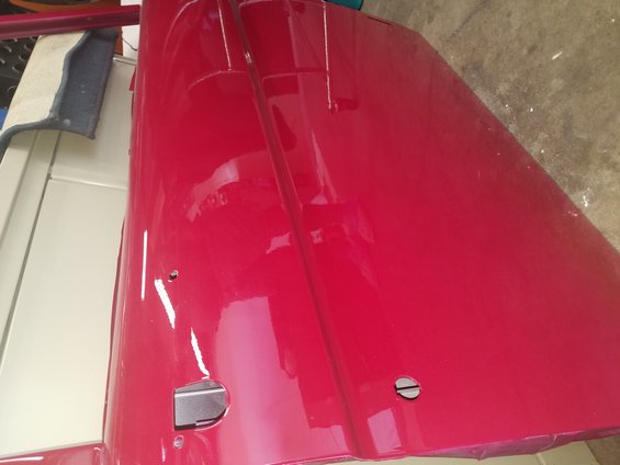

painting the bronco has been a learning experience to say the least. basically painted everything twice for various reasons and then finally went all in with a one time everything gets painted at once as we were having trouble (because of our being new and learning) getting the color to match and to look right. Finally... its painted and except for the cut and buff.... its done.

still not done but i drove it out of the garage to clean the garage out. Still needs front blinkers, hood pins, rear plate mount and a little more trimming on one fender. Really happy with the paint, new raceline beadlocks and toyos. Biggest problem I'm having now is that everything i'm bolting back on looks like junk....

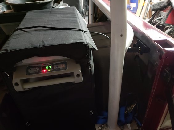

$400 costway fridge and new power plug for it. Used it on the rubicon and it's sweet!
