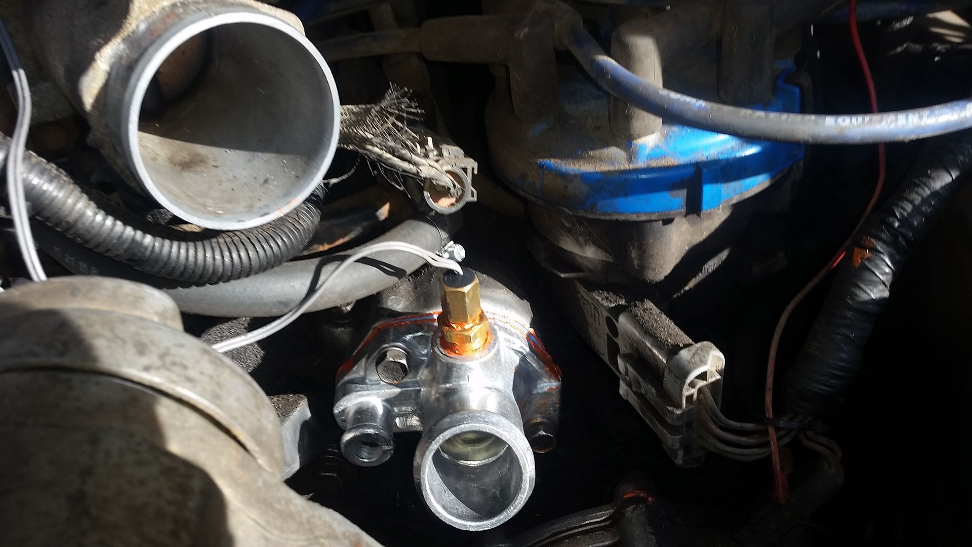

I also cleaned up some wiring so its a little less shit-tastic under the hood. Installed a new adjustable thermostat for my E-fan, working nicely.
