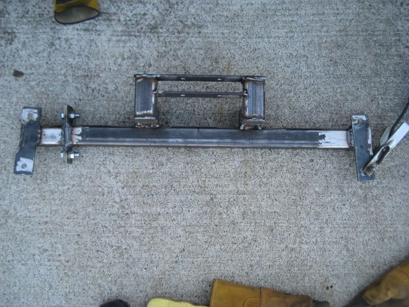

Well it's been a bit since the last update, with a rubicon trip fast approaching I've been doing a little work. I welded up the 8lug spare tire plate and bolted on my only remaining 40mtr. For the first time in a long time I have 5 full size tires on this rig.
Image[
Image[
Image[
Also finished my slyyyders. I used 1.5" tube for the outside and light tabs to connect them. In hindsight I could have made them a bit wider. And of course they bolt on. :mrgreen:
Cut some fenders and went to hollister. Need to cut fenders more, need bumpstops and better shock mounts in the rear.
Took about 1.5":

Its looking sweet! Your far ahead of me! Looking forward to seeing more. :yes:
March 6th, 2015, 1:17 pm
Post Re: Rick's 95 Bronco build thread
Damn Rick, nice work! You going to make the Dusy this year?
March 6th, 2015, 1:25 pm
Nice update. Great to see you got it out in the dirt. We need a better flex shot though, its just getting started in that picture!
Driving impressions off-road with the ZF?
Nice looking welder :mrgreen:

Thanks guys, Im starting to see the light at the end of the tunnel, it's great to be able to jump in and drive the truck, not worried if it will leave me stranded somewhere. (Not that it ever did)
Off road with the ZF is fantastic, downhills are so much easier and the positive connection with the trial is a great feeling. It could use a deeper 4lo, maybe atlas in the future...
Dusy or bust!
