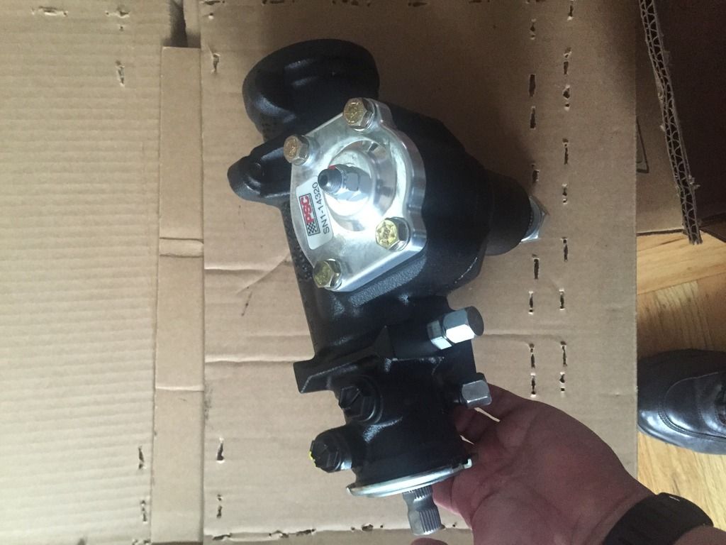

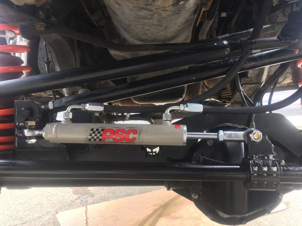

Wow. It's been a while since I've updated this thread, so time for an update. I added some goodies to my junk before Sierra Fest, new steering box and hydro assist.

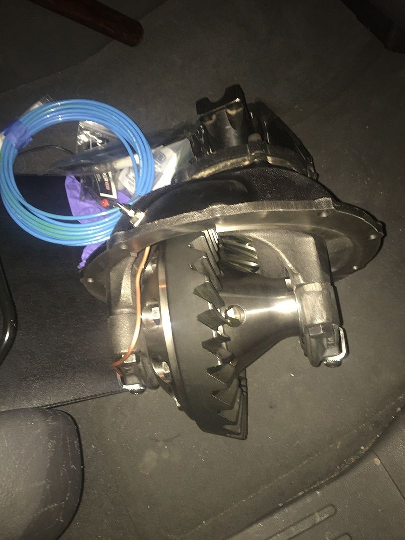

The rear Detroit unloading and pushing in turns was getting old. So I splurged on an ARB for the 9inch.

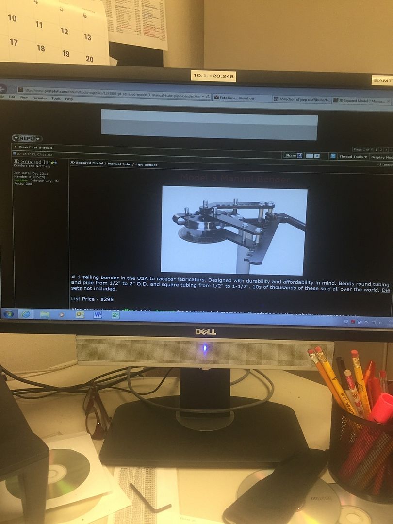

It's been a good summer of wheeling. I'd like to get one more trip in before tearing into the rig this winter. I've got some good upgrades planned, starting with a new tool I just bought.

those are good tubing benders, and they are easy to apply rams to so you dont have to do everything by hand
my buddy nick has built probably 2000+ bumpers on his and it shows no signs of slowing down

Is that an 8" hydro ram? Did you do anything limit its travel so its not smashing against the stops on the knuckles? I love those tie rod clamps, makes adjustments super easy. I was skeptical of the strength but mine has worked great.

That's to to hear. A buddy of mine has one, built his cage with one. He added the ram as well, got tired of having to muscle the tubing bender around.

It's an 8" ram but the guys at PSC customized it for 6.5" of throw since that all the steering I have with my current setup. I left the housing alone, everything has been working fine since I built it. And yes, a roll cage is in the works. I bought some DOM tubing a while back and now it's time to design and build!
