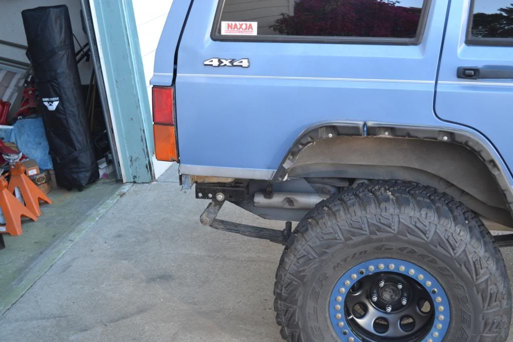

Well, time for an update. The nice thing about an XJ is that there's plenty of room inside for all your stuff. The bad thing is that the XJ is shaped like a station wagon, giving you some overhang that loves to make contact with rocks:
Looking closer, you can see where the lower quarters and bumper smacked a rock:

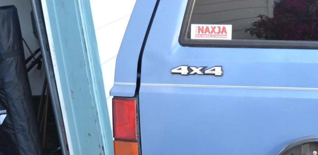

The passenger side has the same look to it and to top it off, the body buckled a bit a the corner of the window opening, right by the 4x4 emblem. Not good.

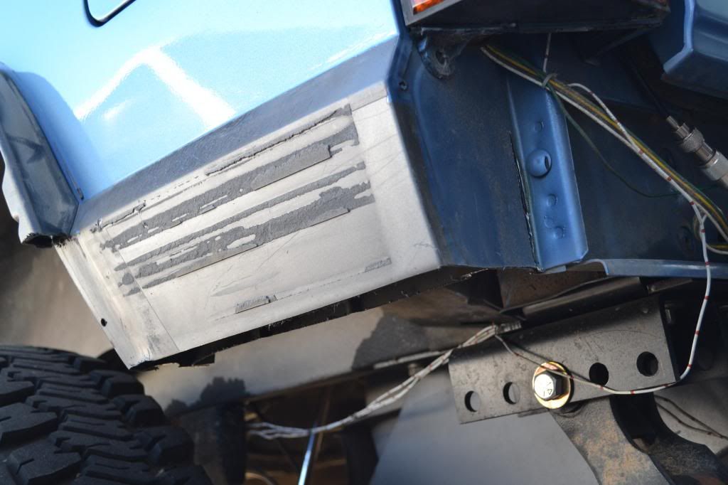

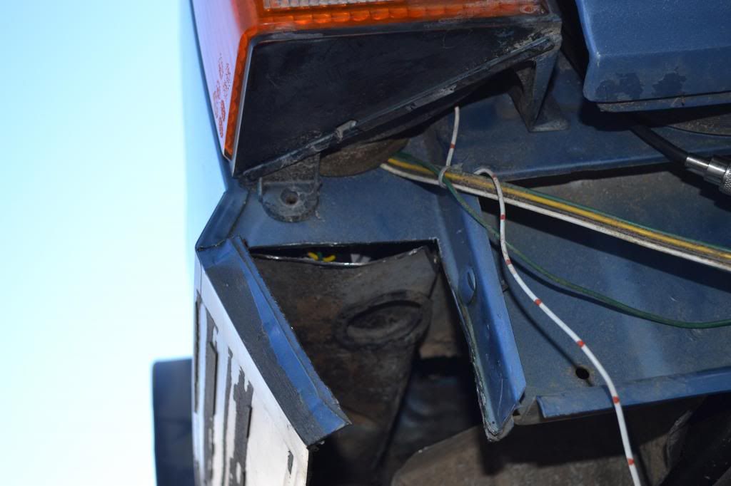

In order to create some extra clearance, and to avoid beating the heck out of the body, I decided it was time to break out the grinder. I followed a couple write ups from NAXJA and Jeep Forum on cutting and folding the rear quarters.
I started by cutting the bottom off the quarters:
Next, I removed the metal between the inside and and outside panels.
Next, I folded the inside panel up, follwed by the outside:
Once everything is folded together, you end up with this:
I still need to finish riveting the panels together and need to add some seam sealer in there to avoid any leaks. Next step, modifying my bumper with some sliders to protect the quarter panels. Stay tuned...

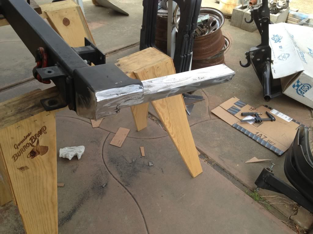

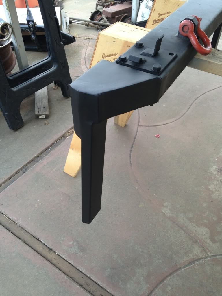

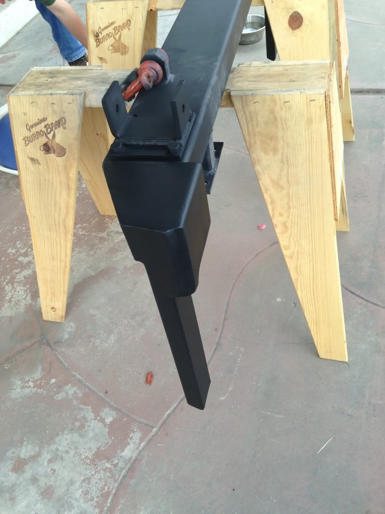

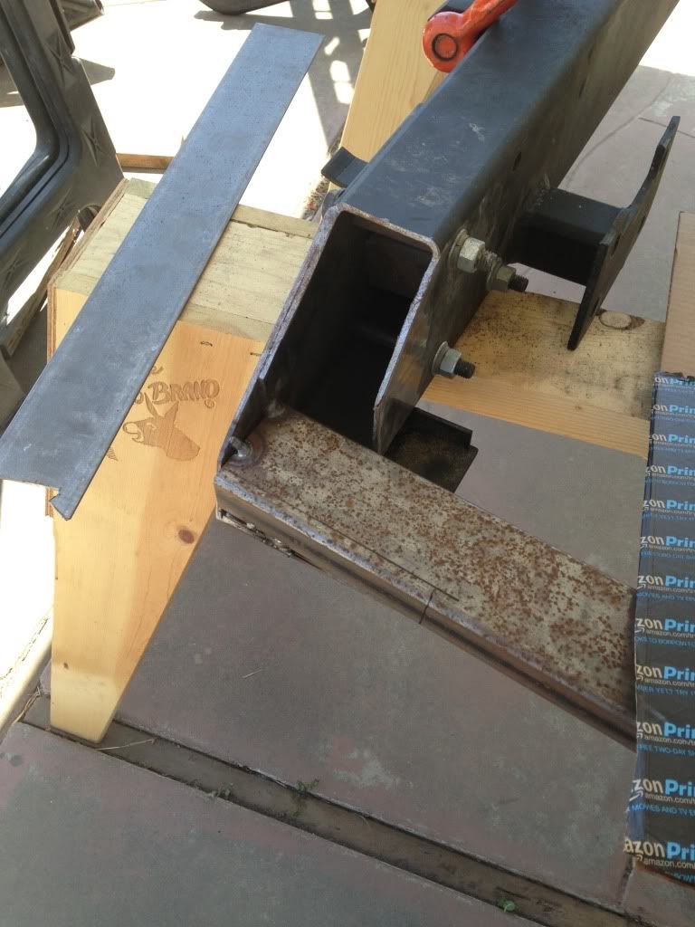

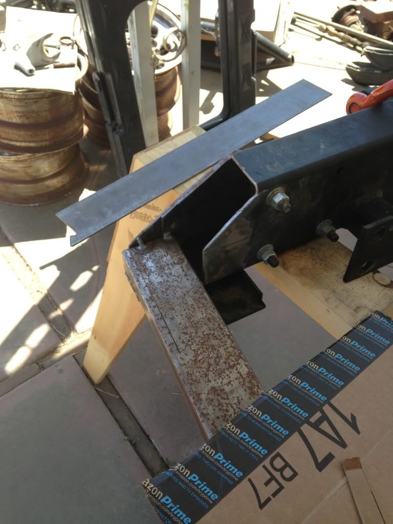

Well, I finally found some time this weekend to work on modifying my bumper. After scratching my head for a bit, I came up with a plan. I cut the bottom corners off and used some 2 x 3 x .120 tubing for some sliders to protect the rear quarters. After measuring and mocking them up, I tacked them into place.
I cut some pieces of 1/8 inch plate to patch up the corners.
Burned it all home.
Cleaned it all up with the grinder, what a pain in the ass.
A little body filler, primer, and paint:
Gonna let it dry and get it back on the Jeep whenever I get some free time. 8)

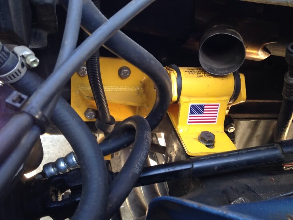

Just noticed I haven't updated this thread since July. Man have I been slacking! I was noticing a weird vibration when letting out the clutch in first gear. Turns out one of my motor mounts was worn out, letting the motor move around. Decided to upgrade to some Brown Dog Off-Road motor mounts. For you Jeep guys, these things are freakin' awesome. Well made and great customer service. I highly recommend them to anyone with a Jeep.
Driver side:
Passenger side:

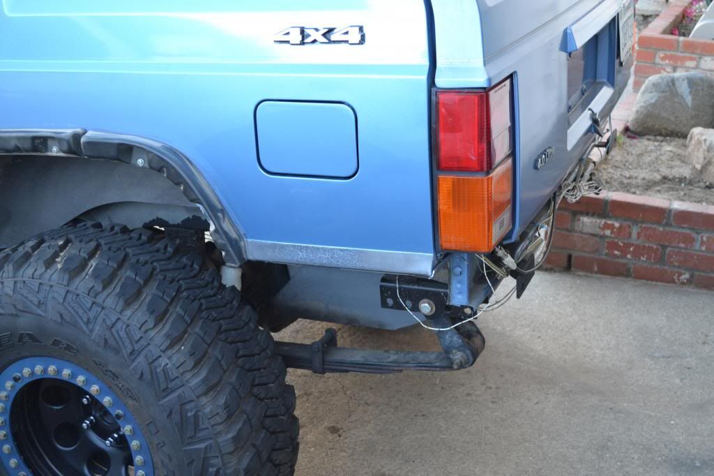

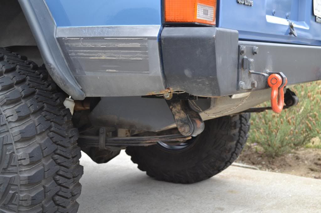

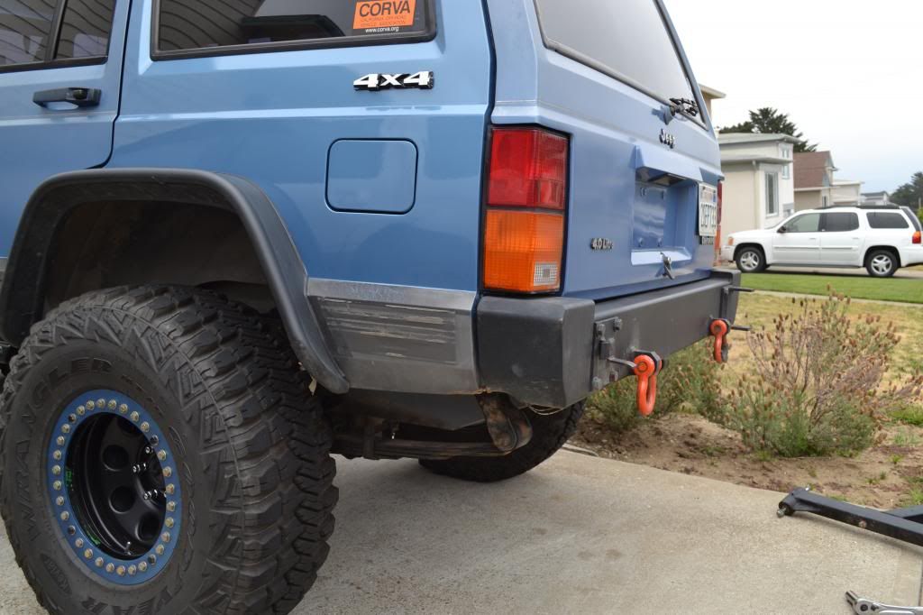

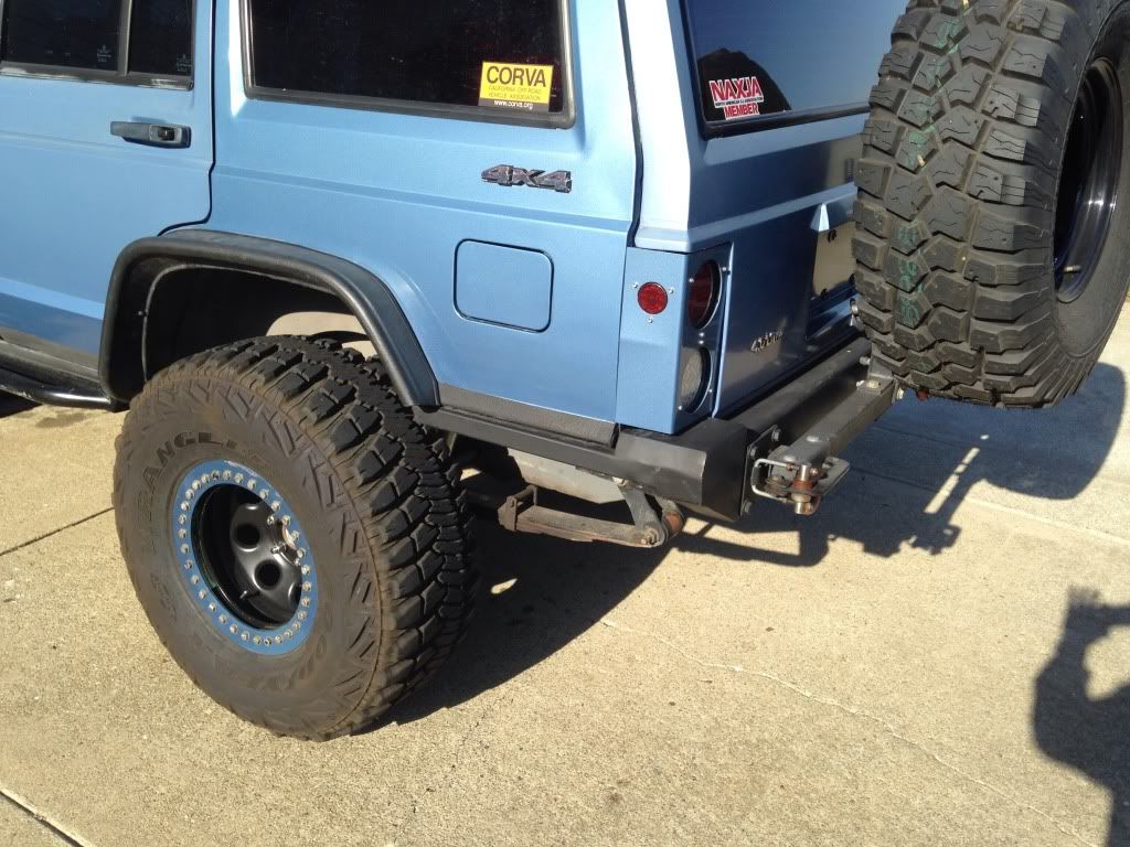

Also finished up the cut and fold, painted and installed the bumper and trimmed the rear flares to match:
