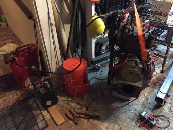

So the block from the first jeep I shot (crack in #4 cylder wall) RIP. Almost anything is repairable, but the bar is set a about $3k max for engine rebuilds, as you can buy them assembled for that much and this block would probably exceed that. With that said, I picked up another civilian engine the other day, although it didn't have the standard low compression head... Instead in a stroke of random luck, it's a super sonic head! (Back in the 40's, that meant a fast four banger!) I'm going to try to fire it up first before I rebuild it. ;)
October 26th, 2015, 8:09 am
Post Re: Jeep CJ2A project
Wow I wrench slow.. :'(
But I fired over the super sonic engine for a second or two tonight! There is no water and it was kinda late so I didn't try it again. I'll kick it over again in the morning. I have a little extra now that the little truck has a new home, so I'm going to start peeping the organge jeep to sale next.
Good times, working with what you have!
