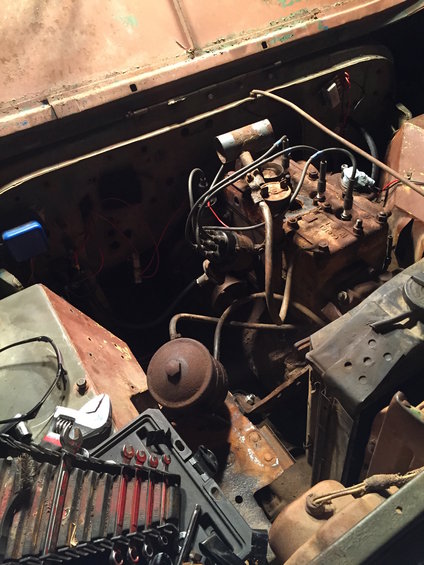

So small update, I removed the broken bolt that holds down the dist (ground smooth, center punch, drill in, then weld nut on, easy back and forth until it was free), tried to flush the water jacket but seems like it has a actually has a thermostat (bummer as it's probably frozen shut), and installed the engine mounts I was using in the 46. Everything was going swimmingly but for the life of me I couldn't get the engine to mesh with the tranny. Even after I found the spy window on the top of the tranny to watch the the shaft / clutch (durp), it just wouldn't seat all the way. So I pulled it out... freaking clutch is mis-aligned and I struggled to align it by hand. Well that put a kibosh on me getting it running for last weekend, but hopefully I'll have it running this week. Once it's seated with the tranny, I still have a fair amount of things to hook up, work on the timing, fill radiator to flush (also destroyed the old temp sender and when I used the extractor to get it out, the whole bushing came with it, so I need a new bushing too. Did I mention I also snapped the exhaust off the manifold? I'm going to using bailing wire to get it going but I'll need to replace that before the jamboree. Suck, felt like great progress and then stupid little stuff just stopped it. Good news is last weekend I work more on the cabin!

Quick update: Got the engine seated finally! Started reinstalling the everything and progress is rolling again. Hoping to drive it again soon. Btw this engine sounds good, totally easy to start and pures.

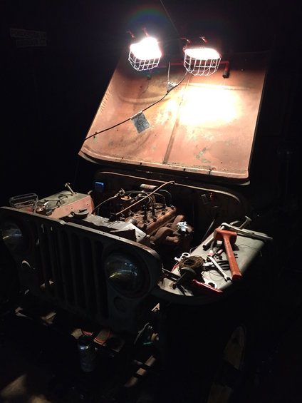

I'm a night owl

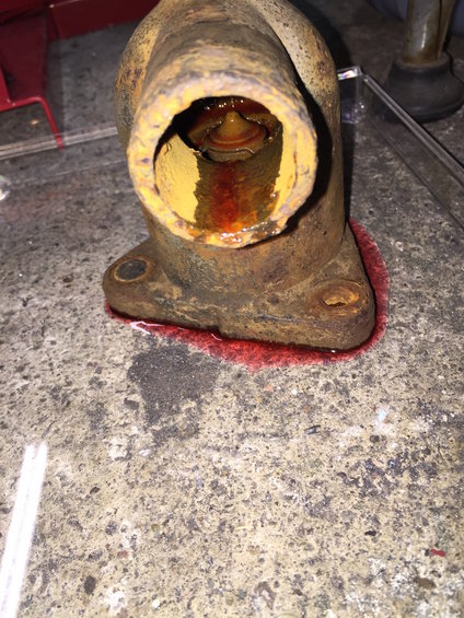

Some ATF to break the thermostat out of the housing.

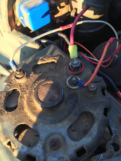

Cabling on the three cable alt (not pictured, ground cable to right stud)

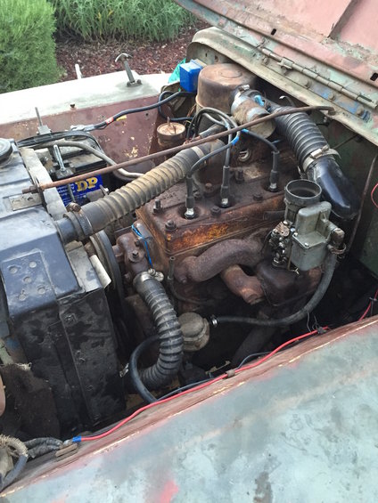

Back together. My intake metal tube was loose on my jeep so I need another extension of soft tube before I can use the tube mounted on the head. The breather was off the carb because the carb was dumping raw fuel all over itself. Had to take it apart and adjust the float to drop the level in the bowl a little.
