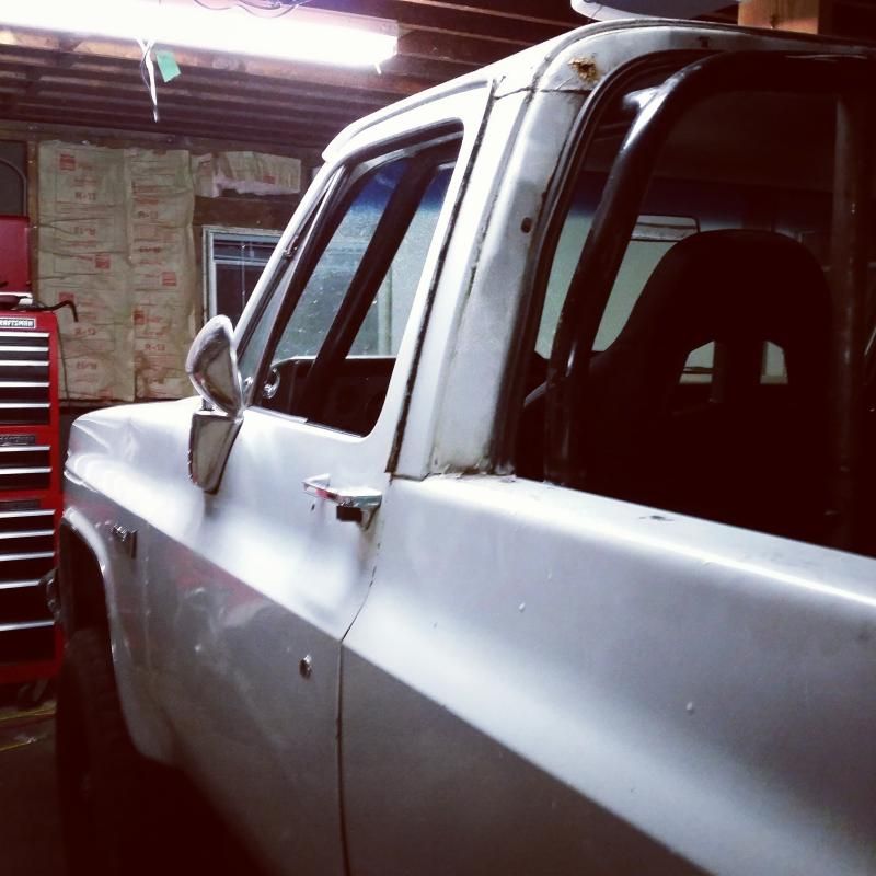

So once i got the truck home which was about 8 months ago i quickly got to work. The interior was more or less shot (5 quarts of oil got squished by the spare tire so carpet was disgusting to say the least. I want this truck to be sort of a simplistic and easy to work on so i tore the carpet up and started to bedline the inside of the truck. I used herculiner which has rubber in it and it came out great. It takes a gallon and a quart to complete the inside from the pedals to the tailgate. There was also a bench seat that wasnt bolted down and obviously didnt belong in there...that had to go so i bought summits racing seats which are really nice quality and pretty affordable.
Day one:
I believe at one time it had the underside coated with some heady duty paint of some sort.
It actually fit in the garage! for now...
Start off the tear down:
Previous owner said he was told the top had never been on...i believe it so i had to change that!

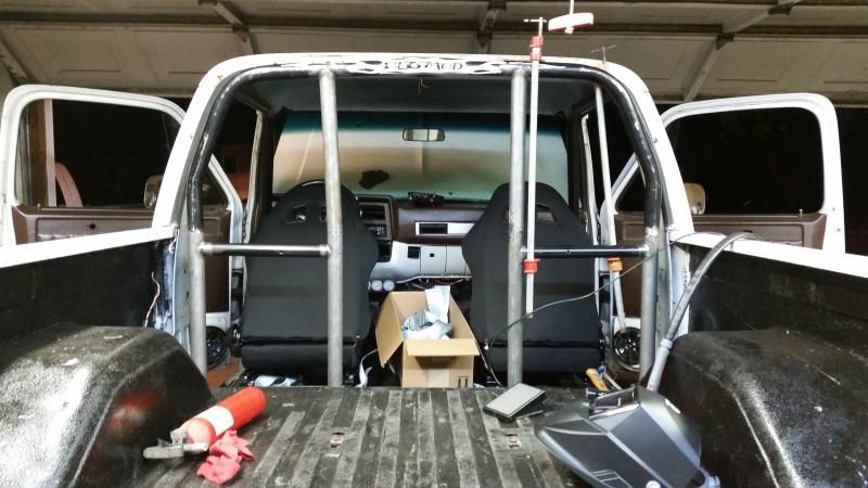

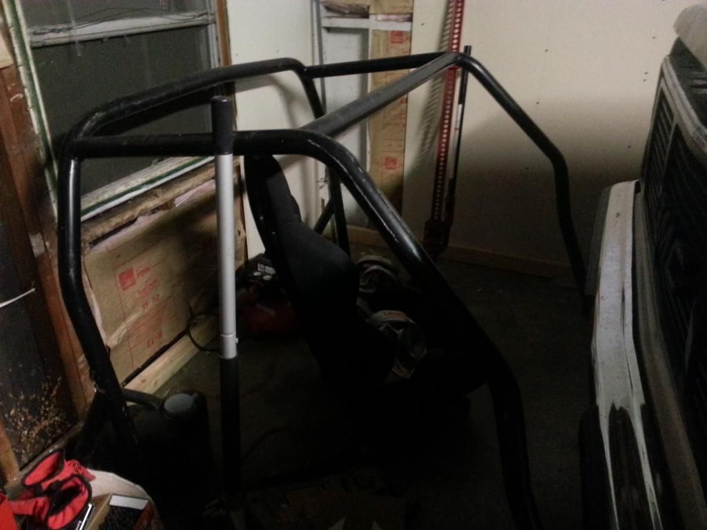

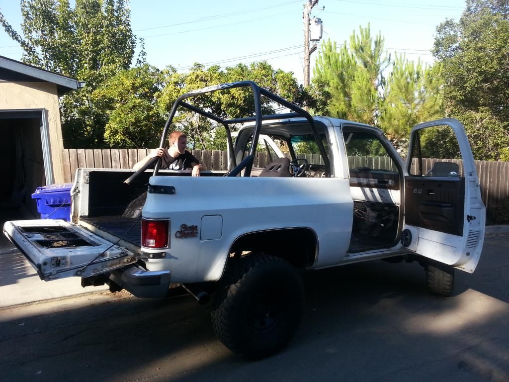

After i got the herculiner done and the seats installed i ended up trading a coworker 2 cases of sierra nevada for a roll bar. It came from a 72' which was full convertible of course so i wanted to try my luck to see if it would magically fit...it didnt.
So i made a few sawzall cuts on it and it fit like glove! I then ordered some plate to tie it down to the body and further down the road to the frame.

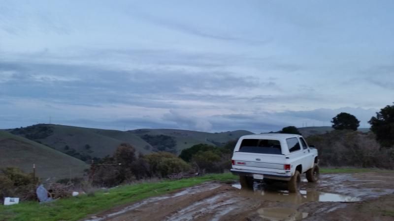

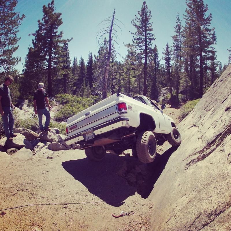

After i got the cage in an opportunity came up to wheel at slickrock up near lake alpine. I trailer-ed it up there because i literally had about 4-5 miles of driving on this truck and didn't know if it would give up the ghost or not. Turns out it did way more than expected and i had no problems. Slickrock is a super small but fun trail Ive run many times before on the dirtbike. Really opened up my eyes to what the truck could do and how much fun this can be!
Got a little sideways and got my first dent but it came out decent with a hammer.
