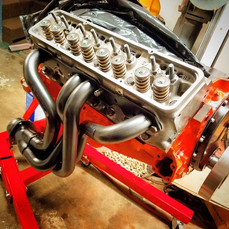

Looks a bit different then the last post! I finished the valvetrain last night. Ready to bolt the intake on today and its ready to get mated to the trans.
May 22nd, 2016, 10:46 am
Post Re: 1985 Gmc Jimmy----The redneck battle truck
That's pretty sweet looking
May 22nd, 2016, 12:39 pm
That is good looking. I'm looking forward to building the 2a's motor, but it's a little smaller.
May 22nd, 2016, 4:46 pm
Thanks guys!
It was an awesome experience rebuilding the engine. I really look forward to the next engine build!
