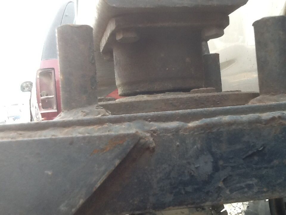

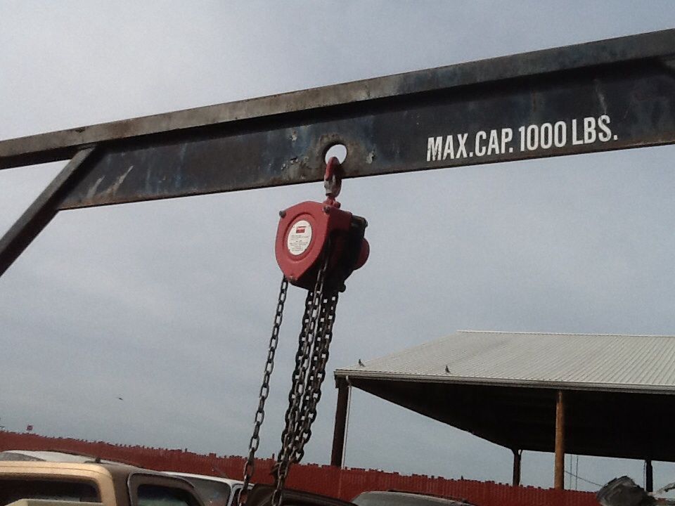

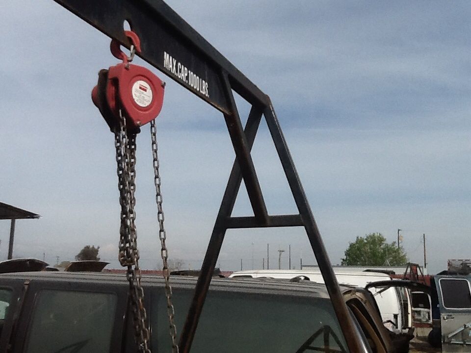

I've been thinking about building one of these things for some time, took some pictures today.
I have a chain hoist already, the material isn't hard to come by.

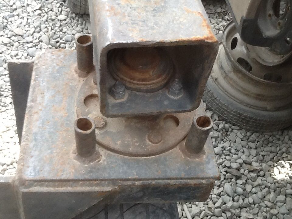

I need to know what type of spindle components they used, so I know what to search for.
They used the little donut spares.
I didn't get a good look at the wheel hub/spindle, will look better next time.
Having one of these will really help with my truck project, it was easy enough to dump the old cab over the side. Putting on the new one needs to be done more carefully.

Those gantry cranes are worth their weight in gold.

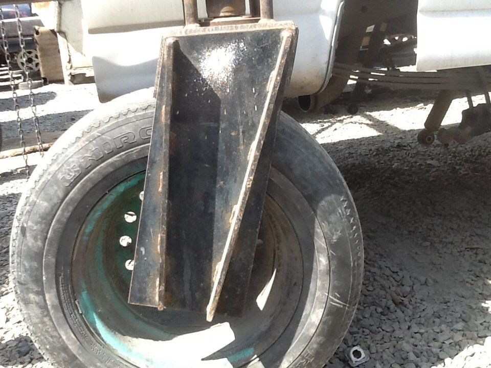

As for the spindles id be getting honda civic stuff since its nearly free and plentiful.

They look like little light duty unit bearings. I know some fwd minivans have trailing arm rear suspensions with unit bearings like that. Probably the same setup on the rear of fwd cars too.
March 17th, 2015, 9:00 pm
Post Re: Wrecking yard hoist build
That's what I was thinking too. I plan on going back with notepad, pen, and tape measure to jot down stuff. Will look at the rear of front wheel drives while I'm there. I want to put the bed back on my truck to see what PTO driveshaft clearance issues I have before drilling for the pillow block mounting. It's too heavy for the help I have around the house, will have to lift the cab one of these days too.
March 17th, 2015, 9:47 pm
thank you google, kinda looks like a rear dodge minivan unit bearing:
http://www.am-autoparts.com/Dodge/Carav ... 58409.html

I found this online, it's $22.31 including shipping. It's the one they bolted the wheels to, and fits a Saturn (except this one is 4 lug). Found them at the wrecking yard today, they wanted $22 and change, $2 core, and tax. I said why would I pay more for a used one, they just looked at me funny.
This looks like the one they used to allow the wheels to swivel around and go in different directions, fits a Chevy Lumina, and a few other GM cars. This one will still be a couple dollars more than the wrecking yard price.

The Dodge ones I saw at the wrecking yard had a gear sticking out the back.

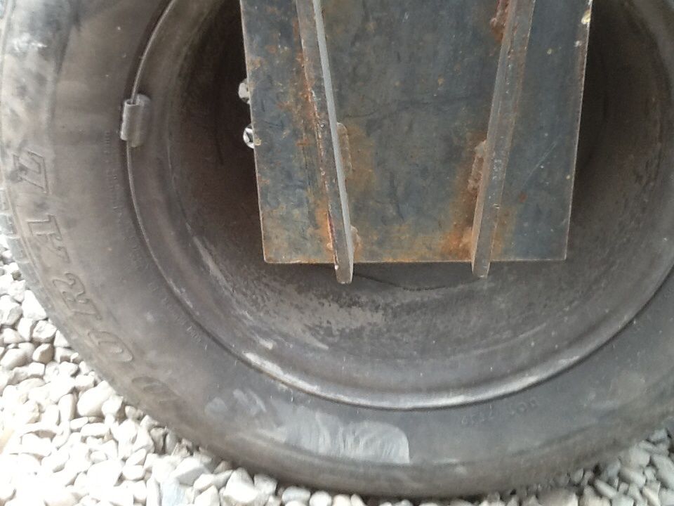

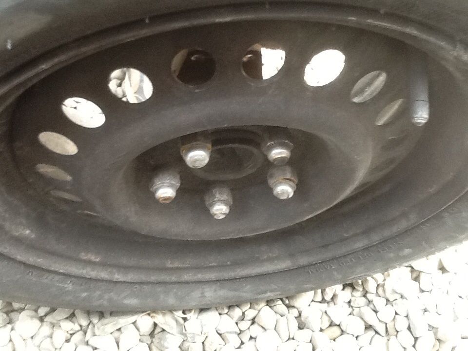

Went back, took more pics and measurements. I think I got everything I need now.
These are angled back 14 degrees, left on one side, right on the other side.
They welded in a 3-1/4" long spacer.
Turns out they didn't use the donut spare after all. Well I got them now, we'll see how it works out.
