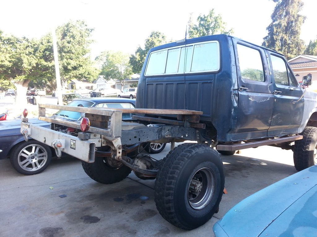

nope, I used the plasma cutter and when I went to pull off the right side of the bed it came loose suddenly and I smashed it into my head..... literally something like this :yes: :idea: :banghead: :oops: :goodfinger:

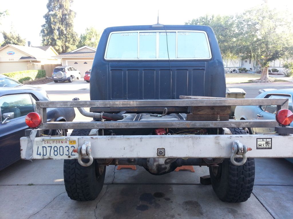

So is that how big your bed area's gonna be?
June 9th, 2015, 12:41 pm
Post Re: not for sleeping
lol, nope, I will be as wide as the CAB and the top surface will be a little bit higher. The lower space that will be the width of the frame rails and about 8-10" high will be closed storage for parts and tools.

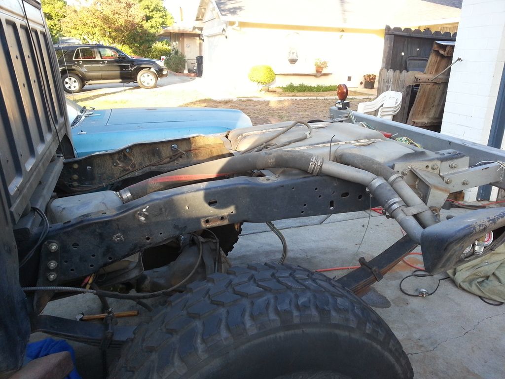

Progress

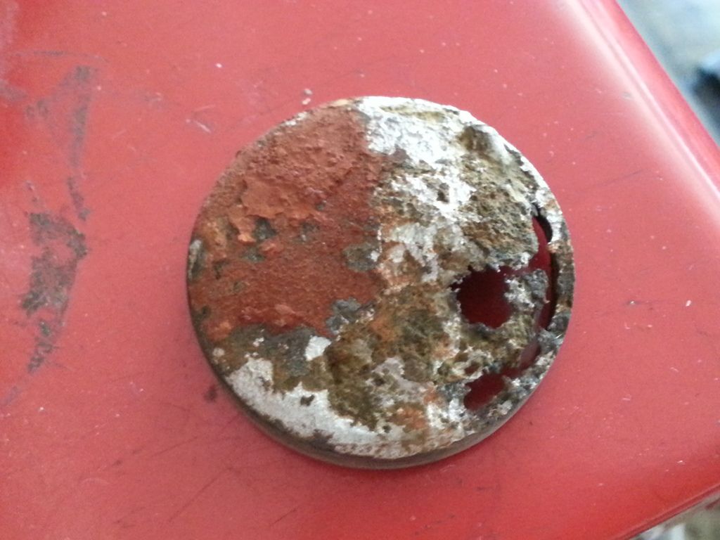

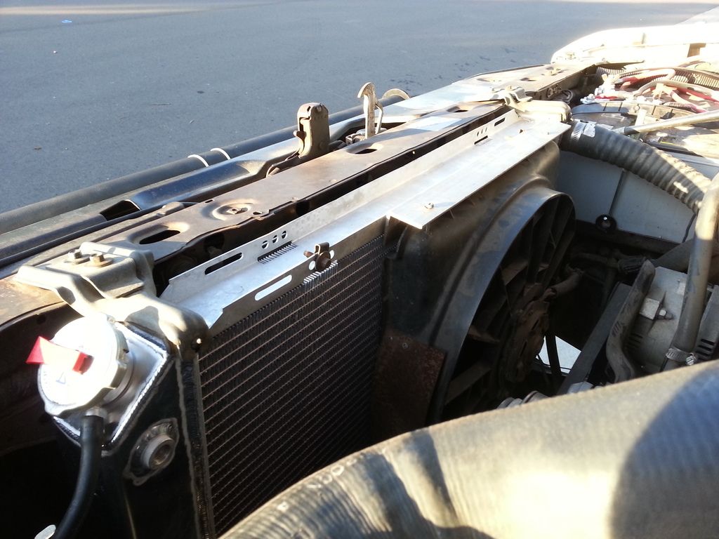

Started off with some cooling troubles fixed. The freeze plug behind the motor mount had to be replaced last weekend.

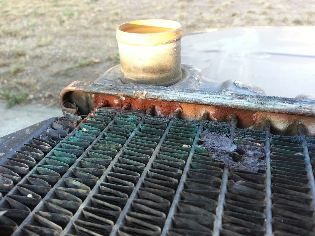

Also been leaking at the seams of the old radiator so I picked up this aluminum one from amazon after two fails from rockauto. I ordered a brass and copper three core and twice they sent me a single core aluminum and plastic.... then the doofuss on the phone told me they don't make them out of copper anymore. seems someone should tell the manufacturer about it since they list them on their site directly
But this little beauty caught my eye on sale for under 200 so I went with it.

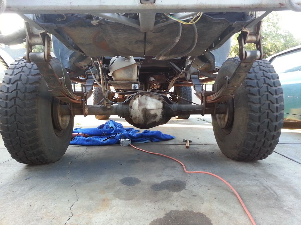

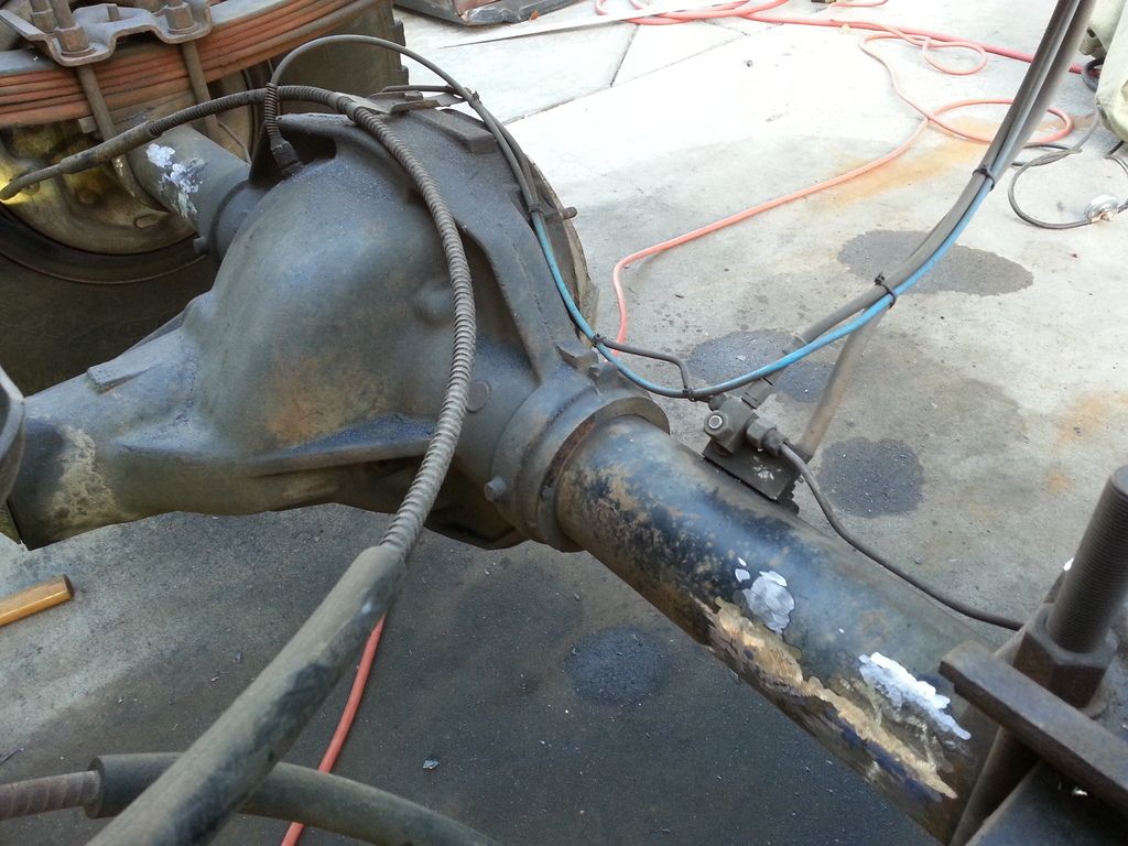

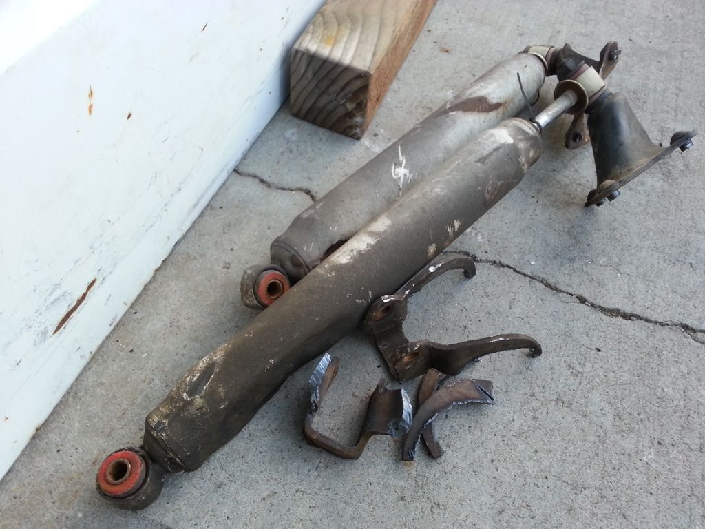

Removed the rest of the bed, took out 10 more rivets on the shock and bump stop mounts, cut off the shock mounts from the axle,
Something about that bare axle tube gets me all giddy
Shock mounts had bent up so bad that the shocks were smashed into the axle tube and one of them wouldn't even compress fully. Guess I'm in the market for some new ones.
look at that nice new clearance.
What did it look like before?
June 14th, 2015, 9:53 pm
Yay amazon!
June 14th, 2015, 11:34 pm
looked like about 2" of smashed up shock hanging down on moth sides

Is that a tbird fan? and why does it look so small? Plans for 2 on there?
June 15th, 2015, 7:10 pm
Taurus fan and it has kept the temp at the thermostat on its low speed so far... I set this one up before we knew about the t-bird unit. I have a t-bird one but since this one works I have left it alone. I may swap at a later date but have bigger fish to fry as it is right now

Progress, worked on the rear frame and its not going to be what I pictured. I wanted enough space between the upper and lower bar to make the tail lights and licence plate like \\\ [_] ///. After measuring the height the bed would end up it would have been taller than the original and put the tool box a few inches over the glass (something I didn't like about the bed setup). Idea now is to make a protective frame for the licence plate that sticks out a little or put it behind the bars and block the everything above and below the mounting screws of the plate (cops might not like the visibility). tail lights will now problaby be - - - [_] - - - still working on that
