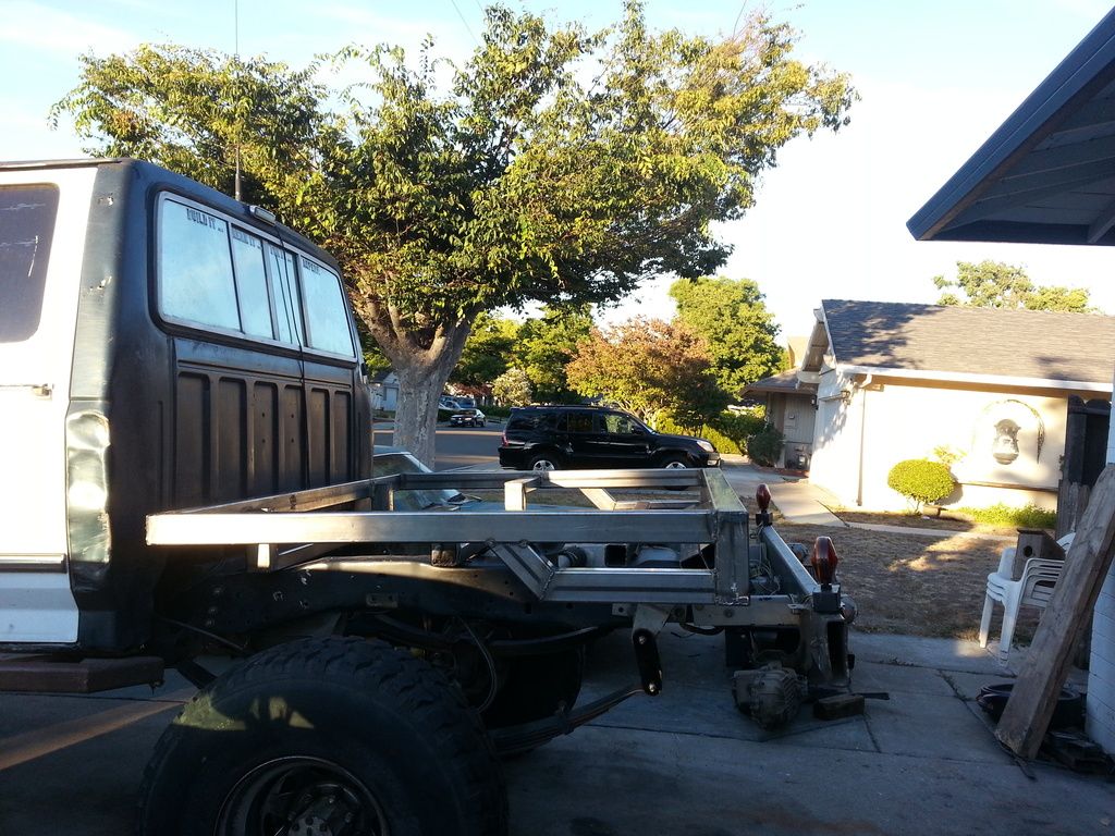

did a bunch of welding. Form is done and now I start adding some skin and a headache rack loop. Then suck the bumper in closer and taper it down a little.
notice the nice shiny new 5" shackles as well
June 29th, 2015, 10:18 am
Post Re: not for sleeping
Looks great! Are you using Flux core?
June 29th, 2015, 11:31 am
yep. no way to use gas outside (windy). lots of crap looking welds and filling gaps because I cut badly but it should be strong enough for me.
June 29th, 2015, 11:57 am
Thats what i figured but it looks good to me! As long as theres good penetration! :yes: Are you going to use the bed for skins?

So I have been beating my head against crappy looking welds for weeks. seemed like the weld just didn't want to stick and lots of spatter. Tried cleaning, tried changing angle, tried different materials, different wire, anti-spatter spray.....
wait for it....
:oops: had my leads swapped so I was welding with the - on the material and the + on the tip :banghead: :banghead: :banghead: :banghead: didn't change it back from when I was playing with the aluminum.
my welds again look nice, now for some :mad: :banghead: rework and get out the grinder...
on a better note, anti spatter spray works nicely
