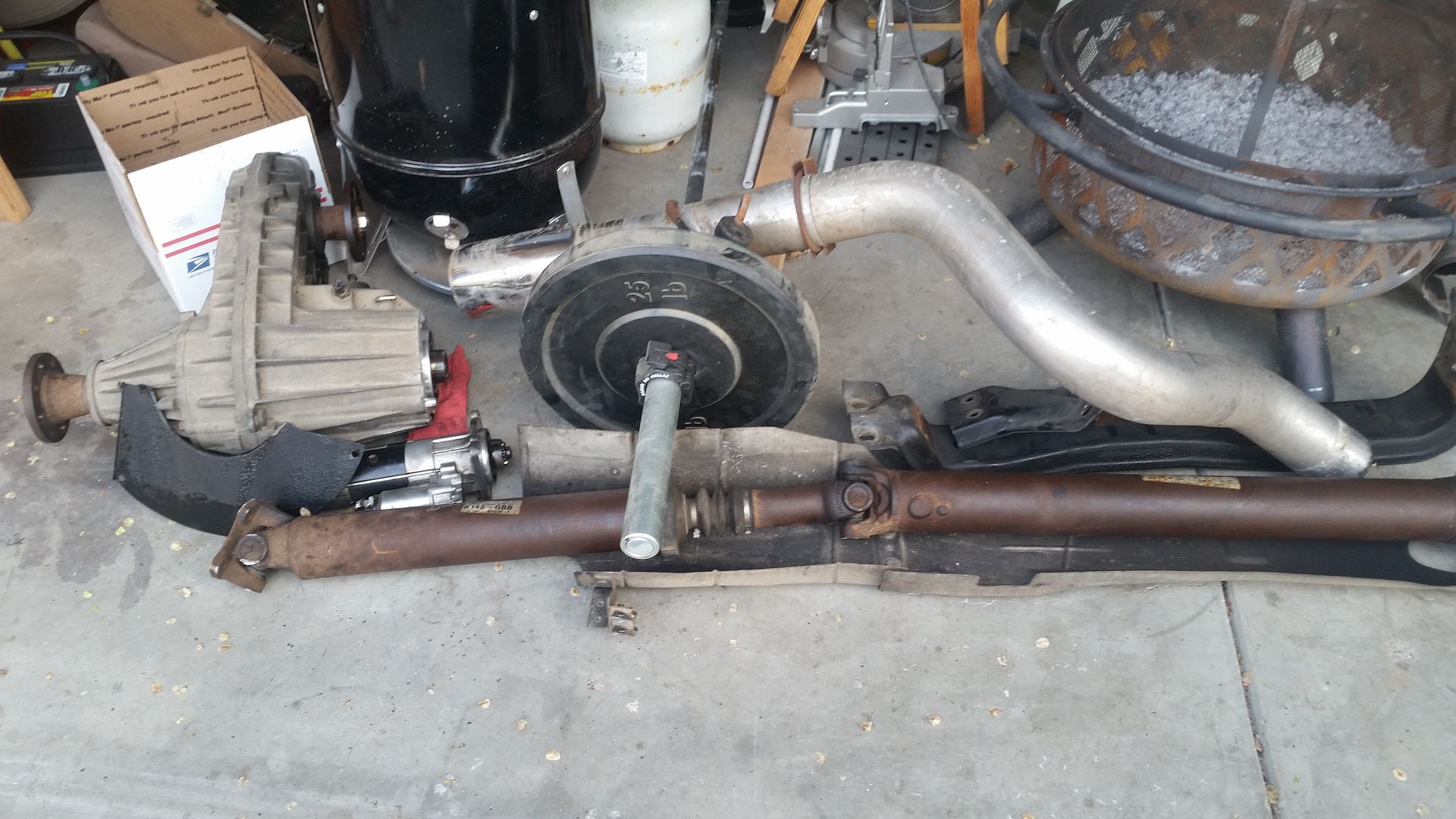

Everything is out but the trans and its ready, xmember is out, etc. Had to remove the damn exhaust and the heat shield around it to get to 2 of the bolts on the tcase.
I haven't found the source of the problem yet but then I haven't gotten to the clutch yet, which is still my leading theory.
The carrier bearing on the rear driveshaft is shot and the ujoints look like they have never been replaced so already found some parts in need of replacement. I guess it comes with the territory of a high mileage truck.

Well trans is out
And the theory was right, clutch disk has made itself into 2 pieces. The center chunk has clearly rotated around the friction material on the outside.
