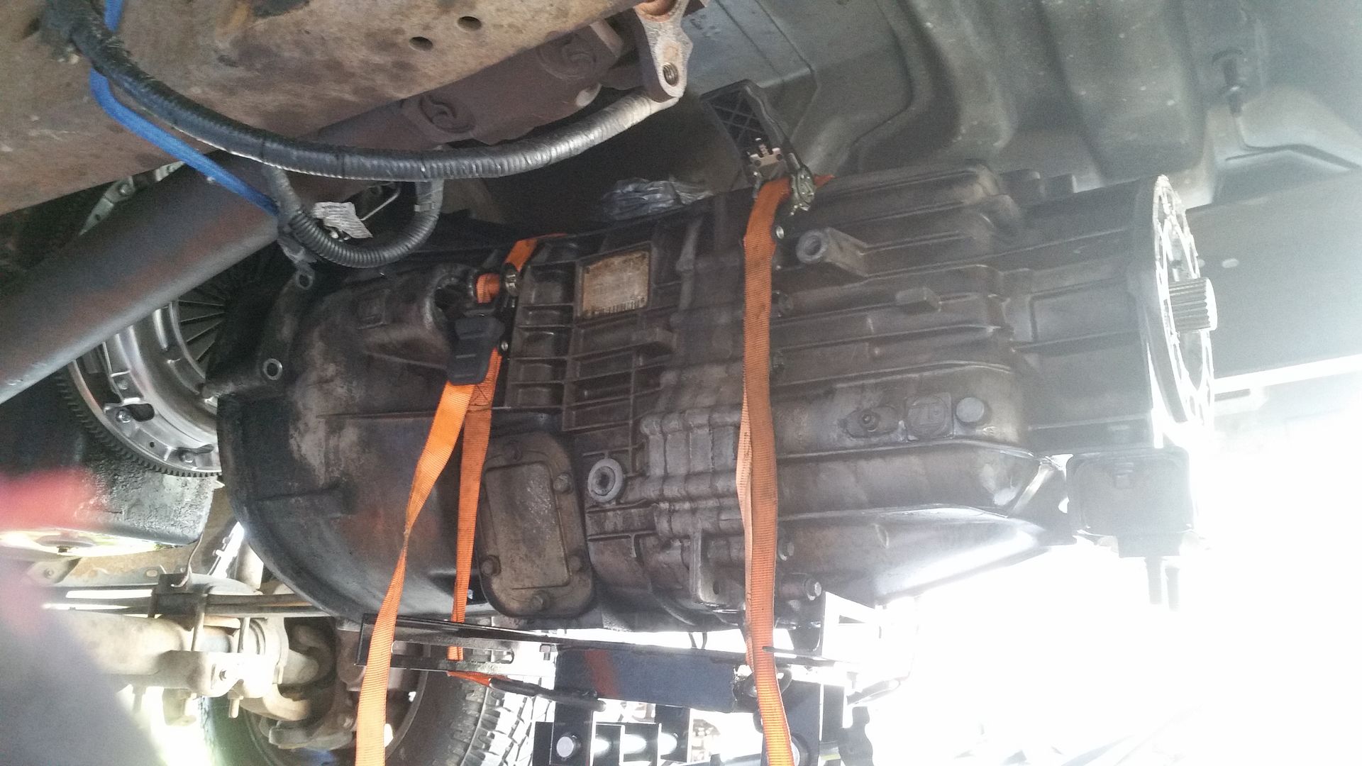

Parts parts parts parts. Went with a clutch kit from valair. Basically one step over stock so it shouldn't be a PITA to tow with. New vs old
Trans going back in. Ask me how I got it on the jack, under the truck, when it sits a full foot higher than the bottom of the rockers. :mrgreen:

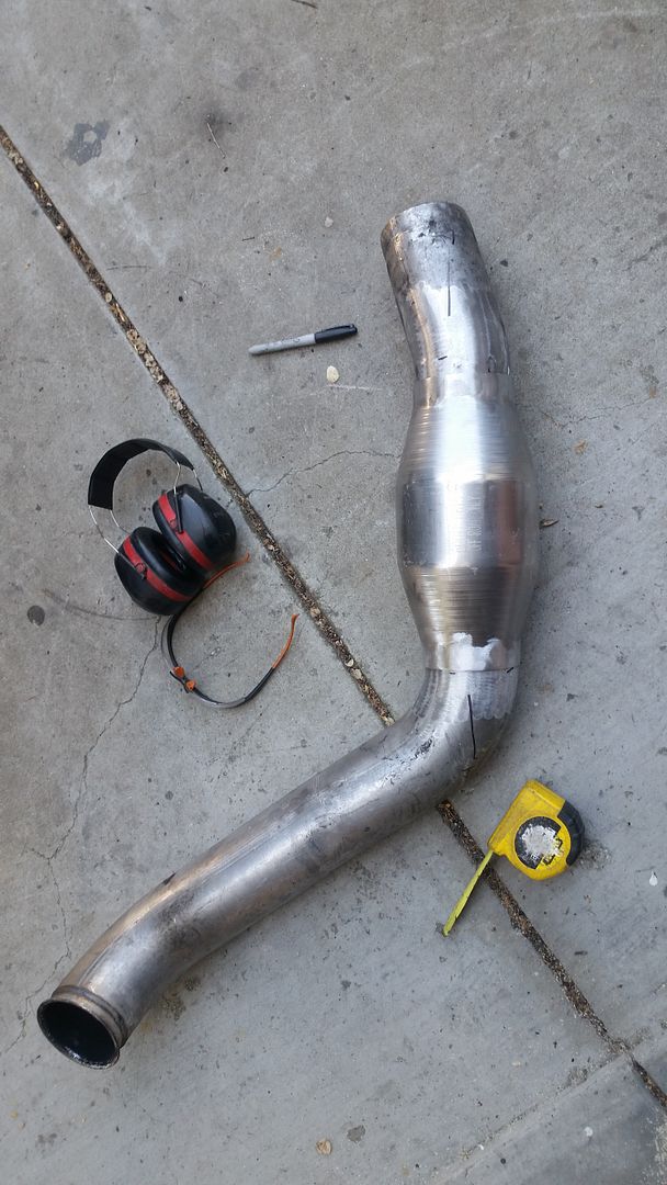

Adding cat... I had to take off part of the exhaust to get to the heat shield, to get to 2 of the tcase bolts... Then I had to take off the down pipe to get the trans out... Apparently a 4" system occupies a lot of real estate :roll:

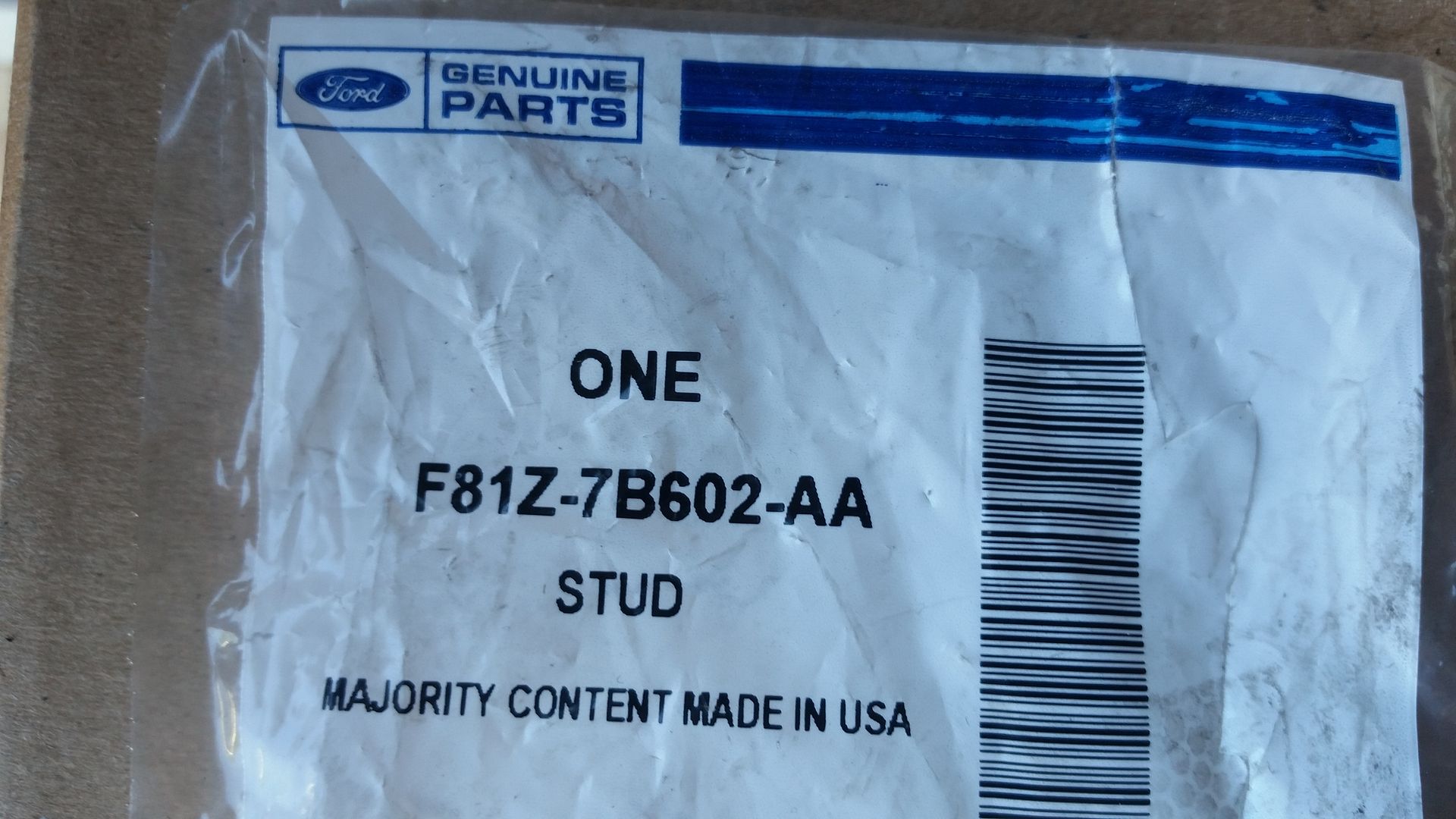

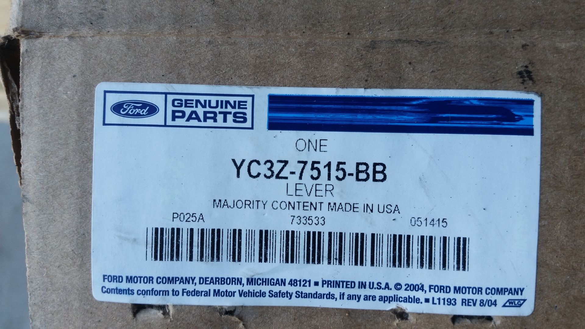

The first couple years of the new superdutys had a weaker clutch fork that was apparently prone to bending. So I went in search of the upgraded Ford part and found one locally at Mission Valley Ford. Also got the plastic bushing guy that the clutch fork pivots on. PN's just in case...
So right now its close... Trans is in, tcase, starter, wiring, there's even fluid in the trans. My rear driveshaft is at South Bay Driveline getting a new carrier bearing and ujoints. I basically need a solid 2-3 hours and it should be driveable.

And finally, because I ran out of time, but mostly because I really wanted to hear it, I ran it with just the downpipe and cat on (cat is in the downpipe) so theres about 3' of exhaust dumping right next to the trans. It sounds amazing. I may never put the rests of the exhaust back on :mrgreen:
