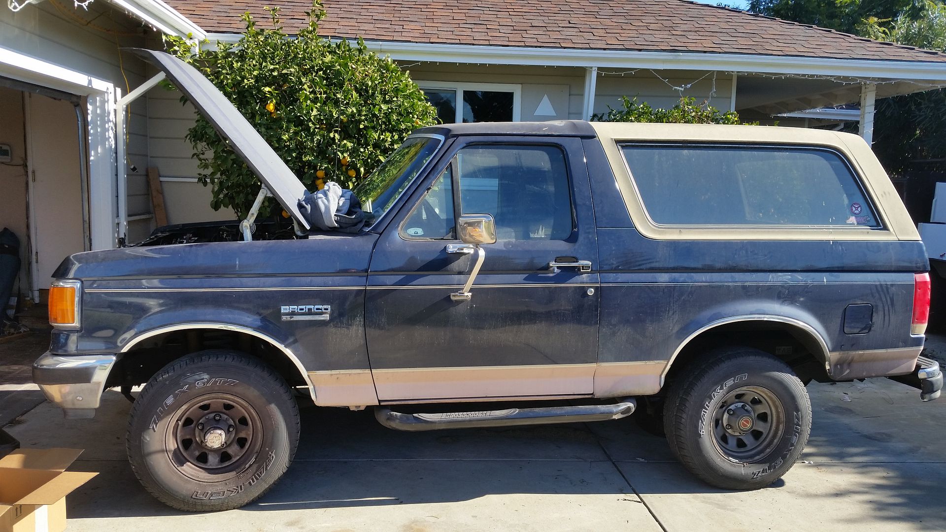

I wrenched on it Thursday and took a few pictures. First, there it is, in all its glory

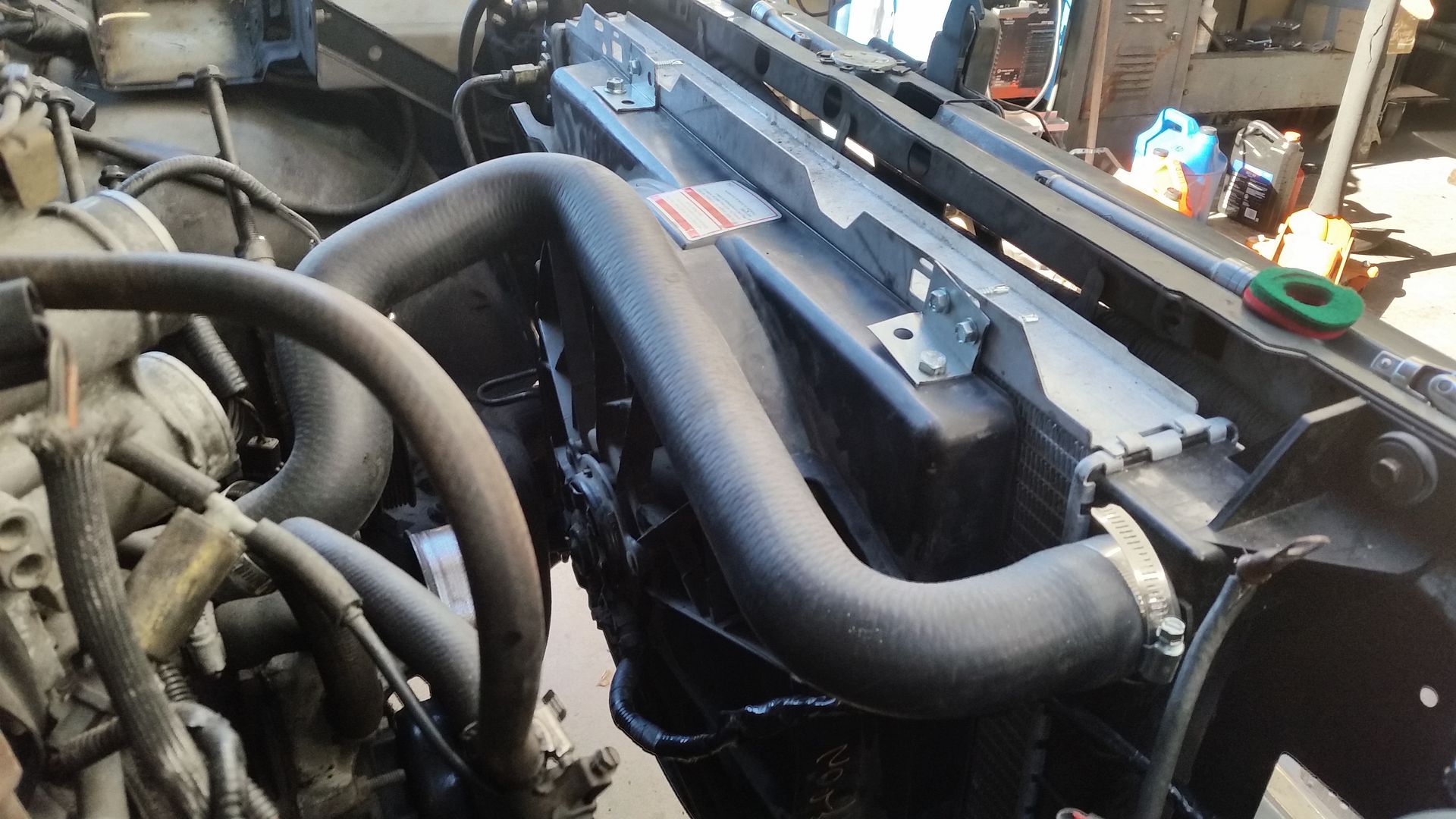

Electric fan in and working complete with the worlds best brackets and most awesome wiring

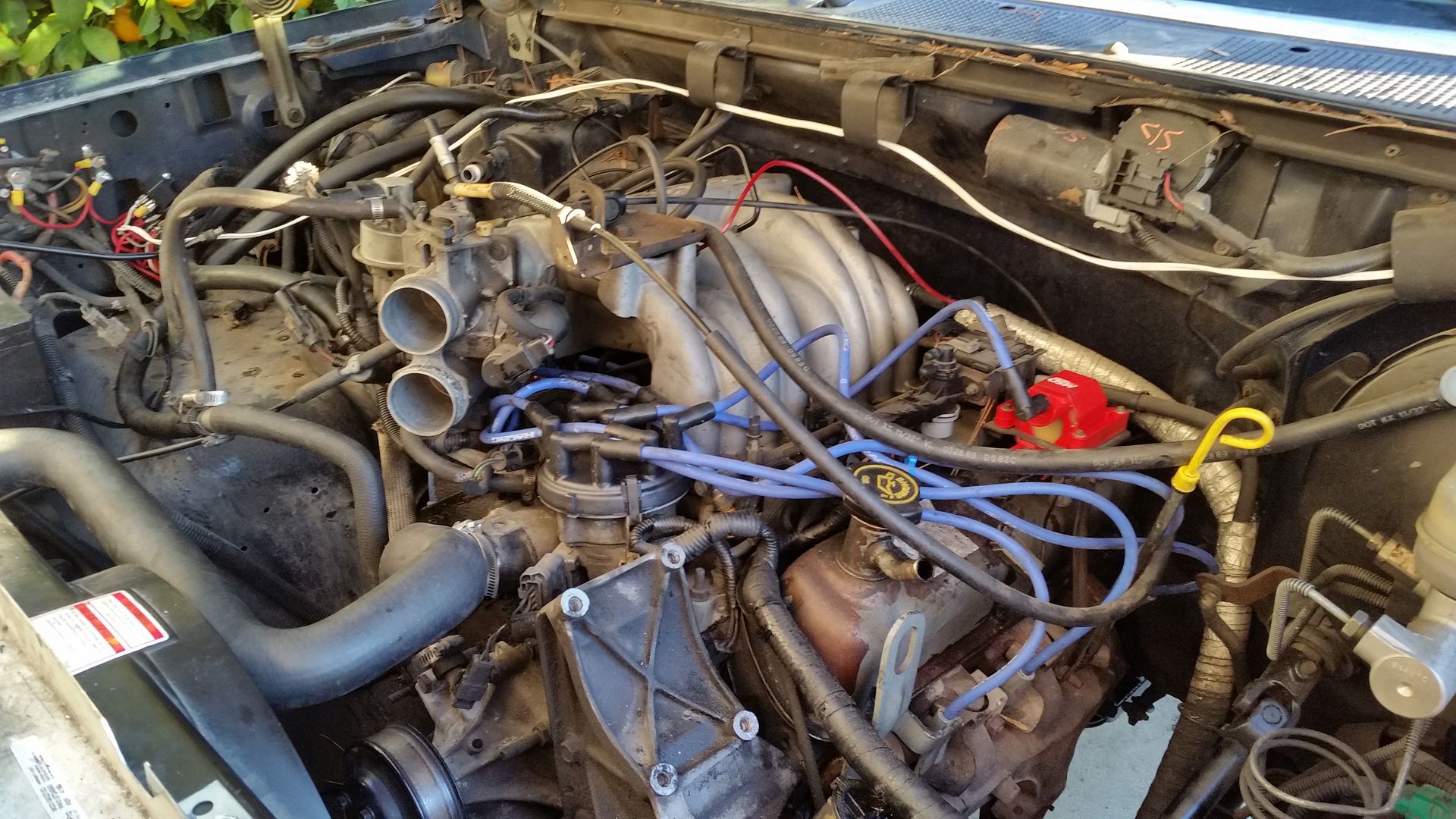

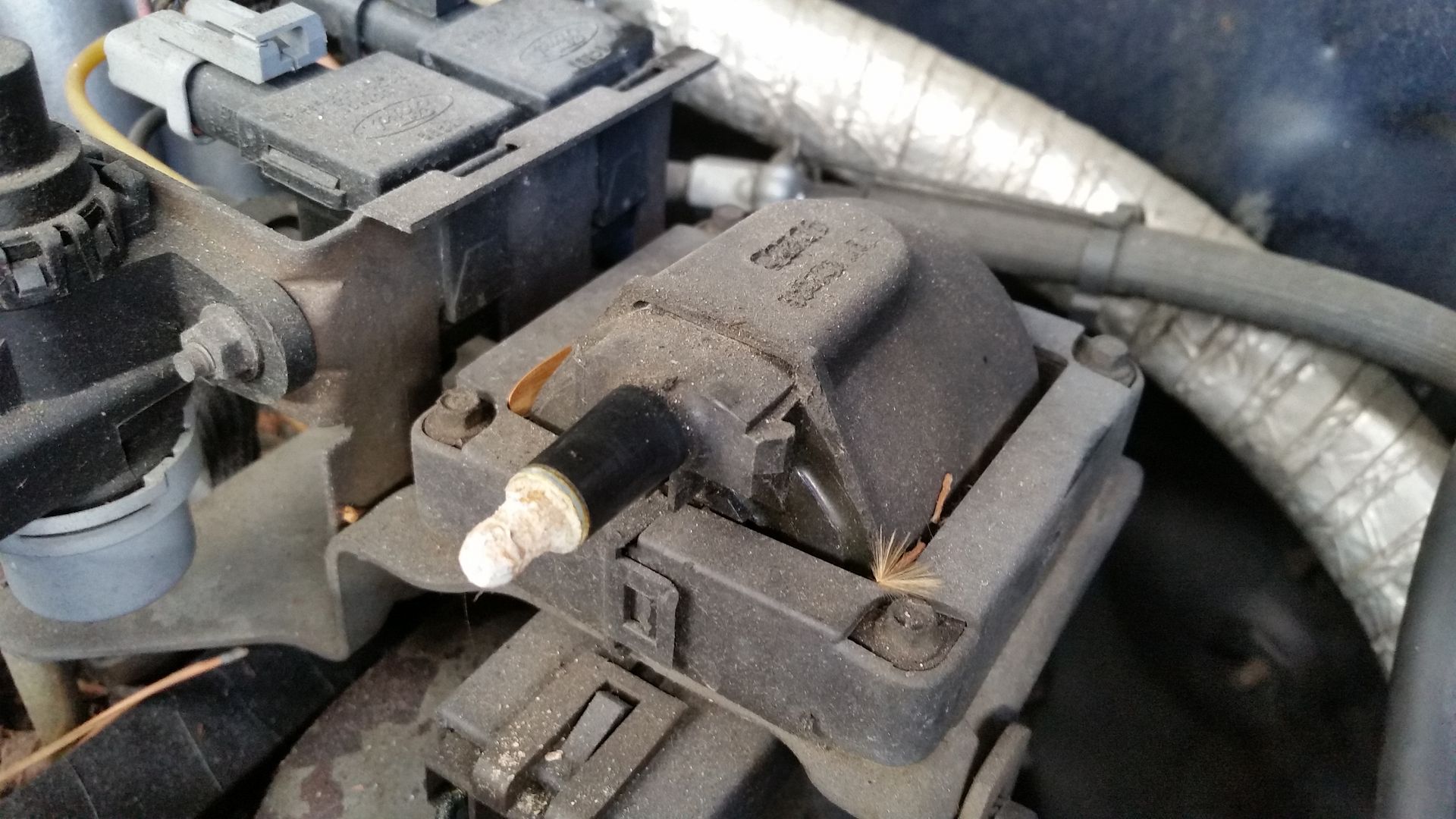

The coil was in real nice shape, I can't believe the truck ran as well as it did!
I replaced the spark plugs. 2 were loose and nasty from fuel and what not blowing by the threads. None of them looked good. Put in some new cheapo autolite coppers with a gap of .055, stock is .047. Step 1 of the sixlitre tune up. Then put in MSD coil (it was on sale on Summit for $45!), 9mm wires a new cap and rotor and boosh, donesies. Plus 5 HP for the ford racing blue wires.

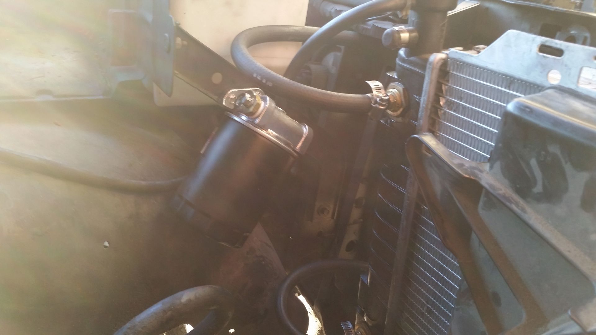

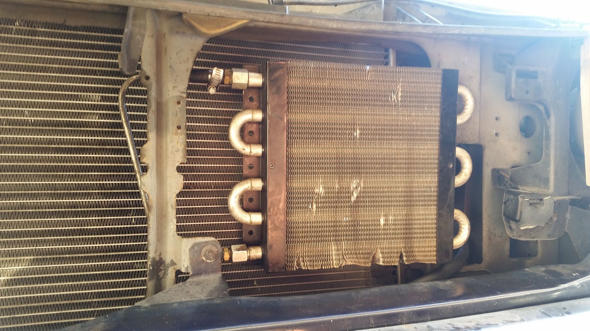

Then I plumbed up a cooler I had from my automatic days
And when I was digging through the garage I found a remote filter I had lying around for some reason so figured why not, plus its a good place for a trans temp gauge, which I believe was installed by the Sunday crew so I'll let them take that.

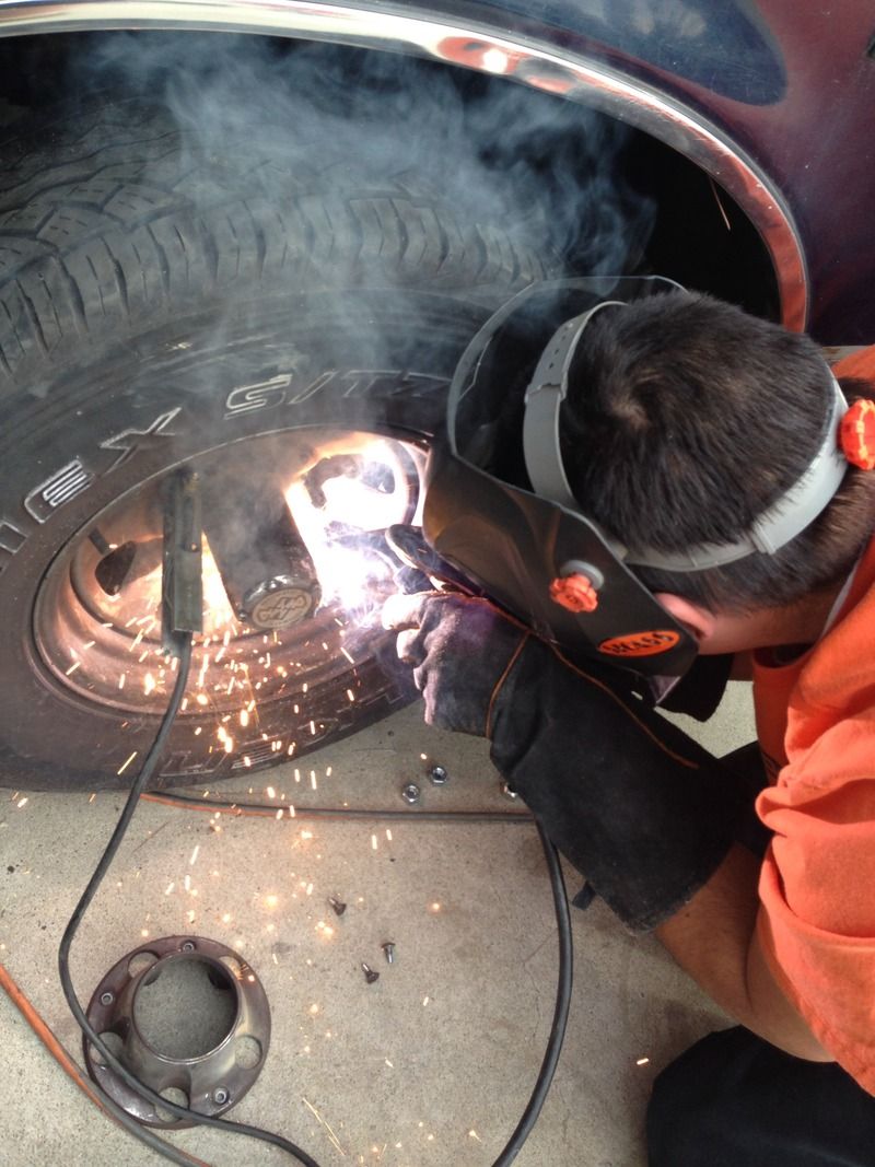

Ryan welding some nuts onto the fancy lock lug nuts so the tires could come off

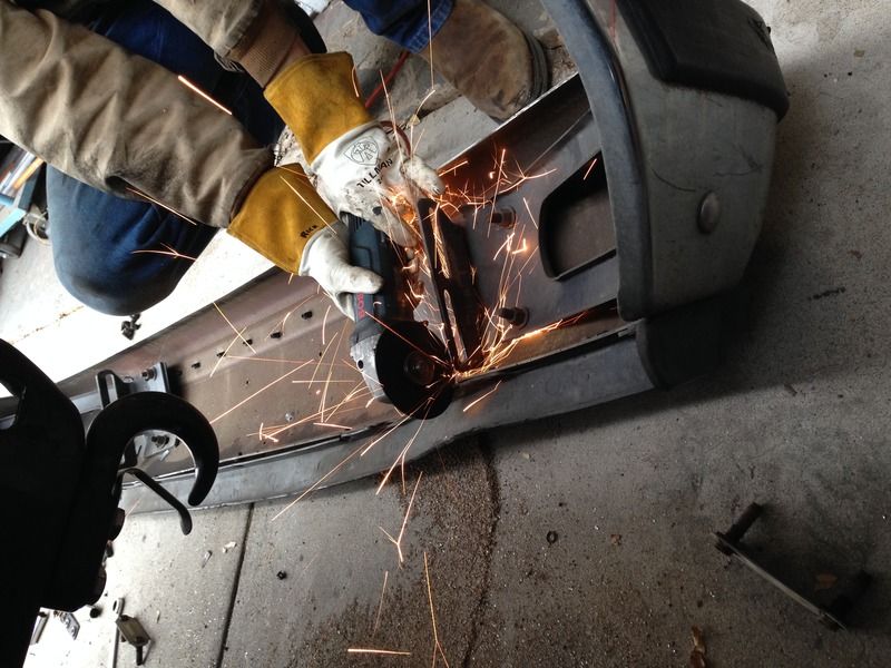

Peter drilling some holes for the tow hooks

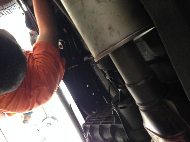

Ryan and I under the truck just before we cut the exhaust off. We left the first cat on
Peter clearancing the bumper for the tow hooks

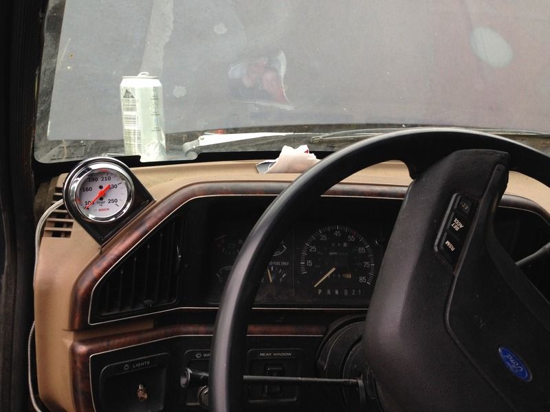

Tranny temp gauge mounted up

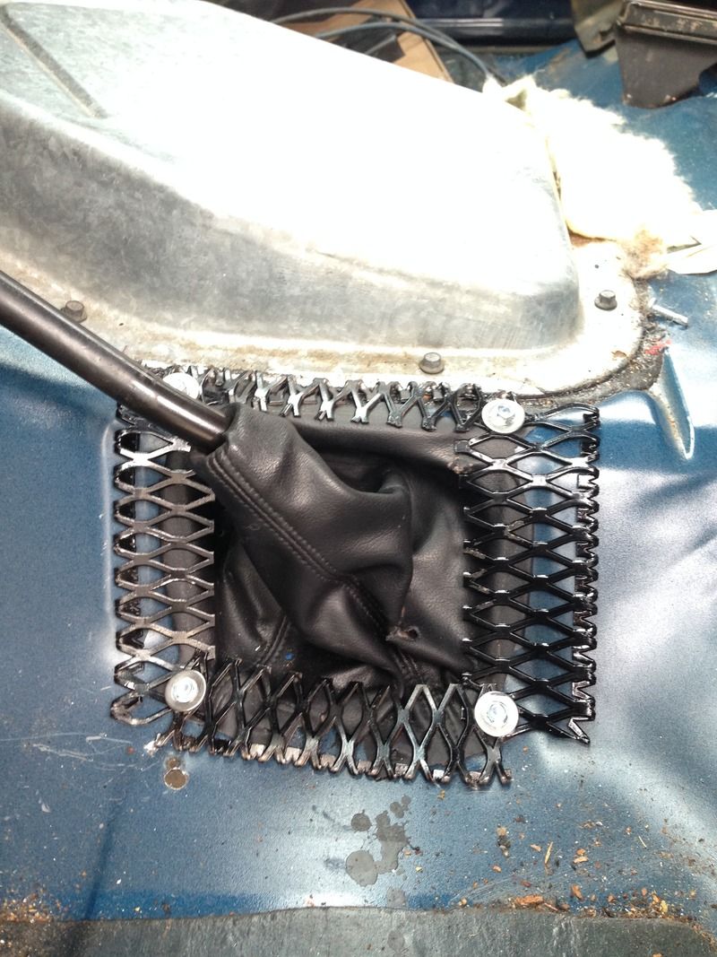

and since apparently the plastic piece that makes the rubber shift boot work got tossed I fabbed up with thing with some scrap and a subaru shift boot that has some sweet cigarette holes in it from ricks new DD since he had a replacement in stock

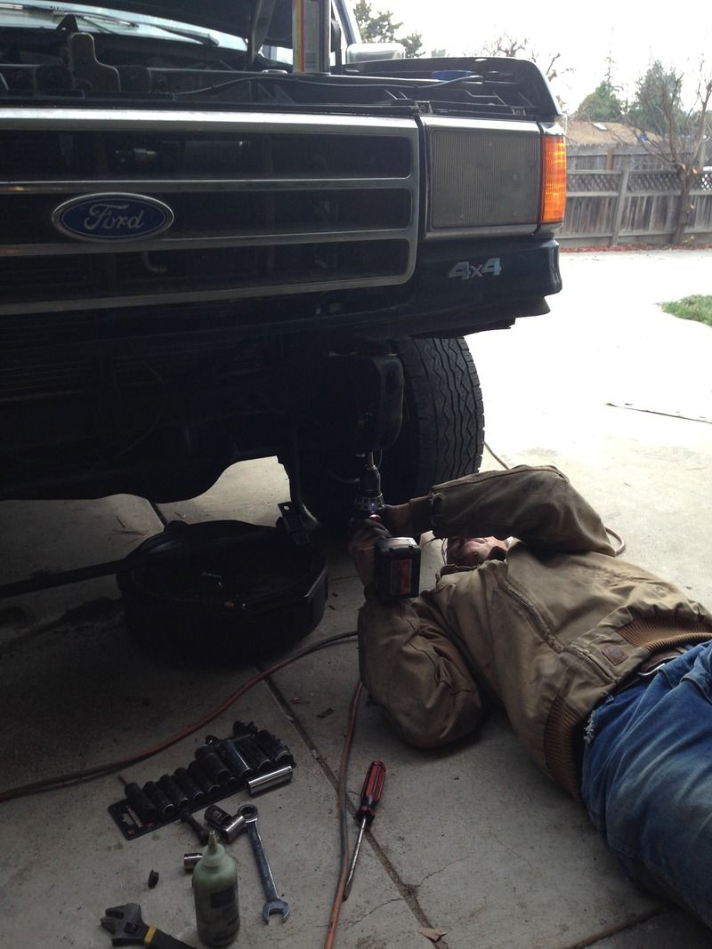

Also both sway bars were removed as well as the rear bumper.
