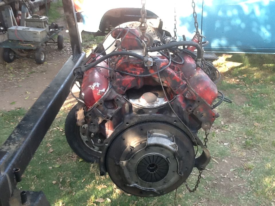

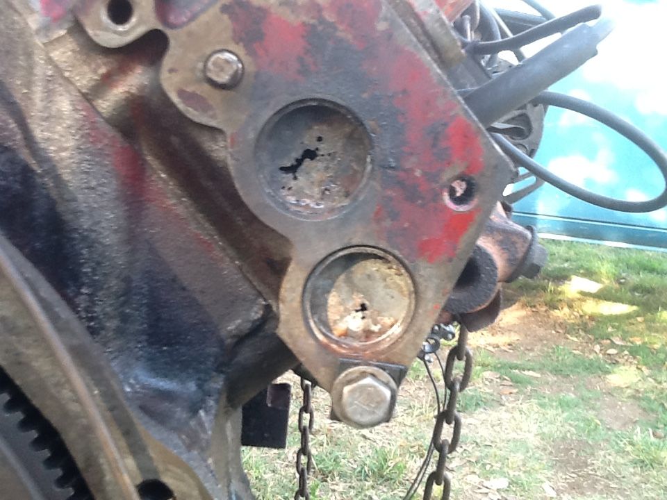

Recently pulled the engine out of my Travelall, it had a freeze plug leak and bad oil leaks. This is after pressure washing it.
There was only one freeze plug leaking, but I found four other potential leaks blocked by crud.
This was my chance to clean up the mess, loving the pressure washer.

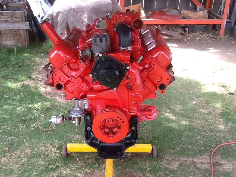

Made some good progress on the engine, still a few things to do before it's ready to go back in. Changed timing cover gasket, front seal, oil pan gasket, valley pan gasket, intake gasket, water pump gasket, thermostat housing gasket, fuel pump gasket, oil filter housing gasket, Installing brass freeze plugs, flushed passages, cleaned up and painted. Still gonna change rear main seal and camshaft gasket, got good used water pipes coming. Harmonic balancer was starting to come apart, installed a better one I had already. Clutch is already rebuilt, and flywheel surfaced.

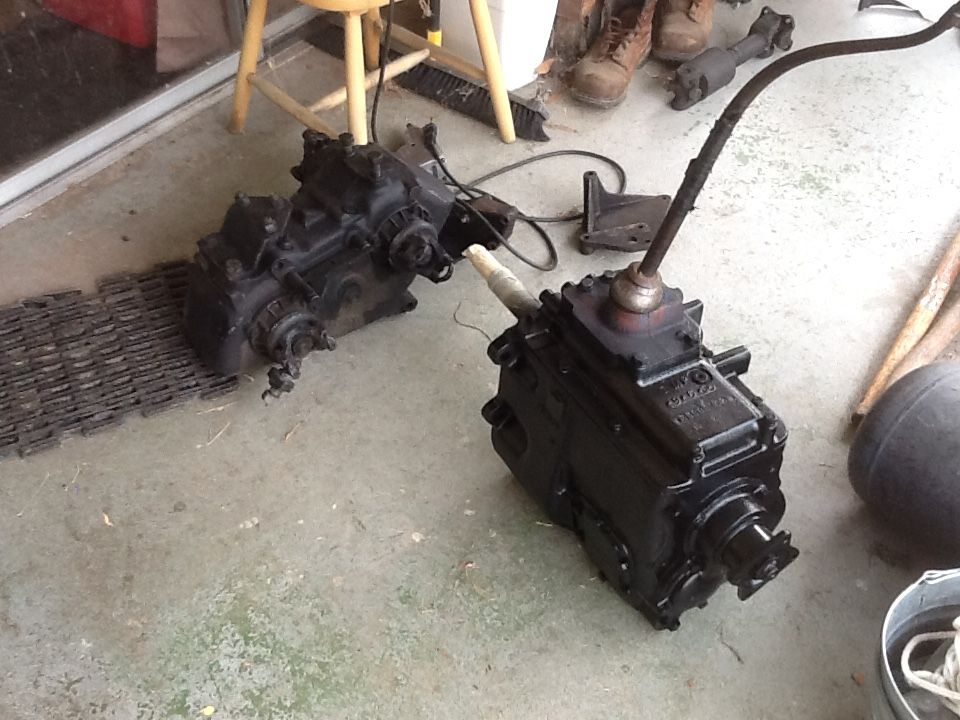

Removed transmission and transfer case. The transmission was a T36, going back in with a T35. This will take the granny gear from 6.21 to 7.17. The only difference in these transmissions is the internals, can't tell the difference from the outside. You have to pull the cover and count teeth, or drop the transmission, turn the input and count rotations on the output. There are three variations, the one in my truck is the overdrive. The transfer case would pop and jump when going downhill in low range, got a rebuilt one from a local shop.
What's going back in, transfer case is a 205. Still need to swap a few parts. I'm not trying to recreate my truck, this is my daily driver. Just trying to make it as capable as I can without going to the extreme of stacking transmissions, also going through stuff to minimize future problems.

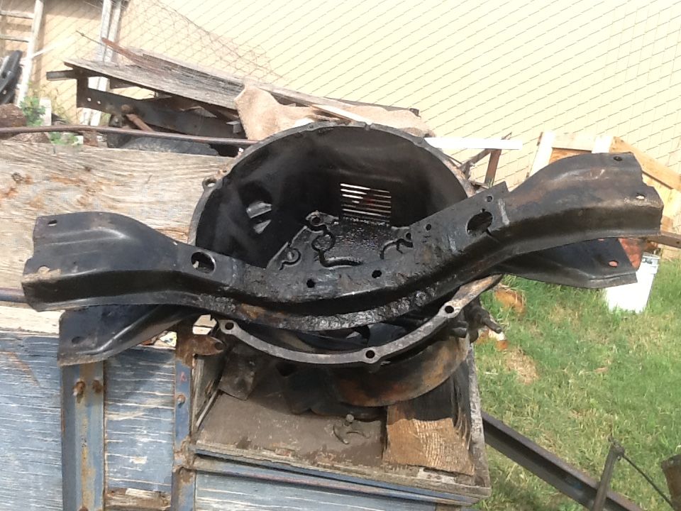

Still parts to clean, and this crossmember needs repairs. I havn't pulled one out that didn't need repairs.

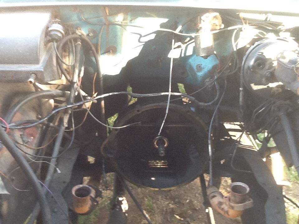

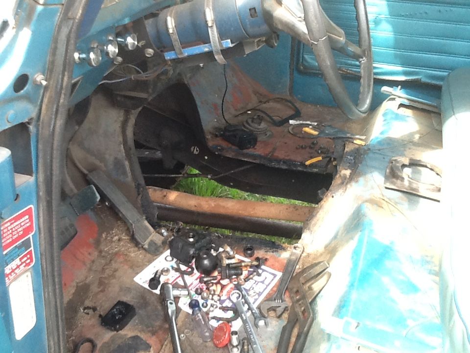

Getting things ready to go back in.

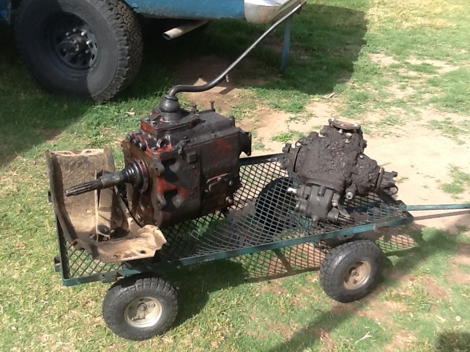

installed new rear main seal today, I use the cup to prevent damage to the seal. The inner part is going over the crankshaft at the same time the outer part of the seal is going in, I damaged the rubber part on the first one I installed without the cup. Someone on an IH forum told me to do it that way, works good.
