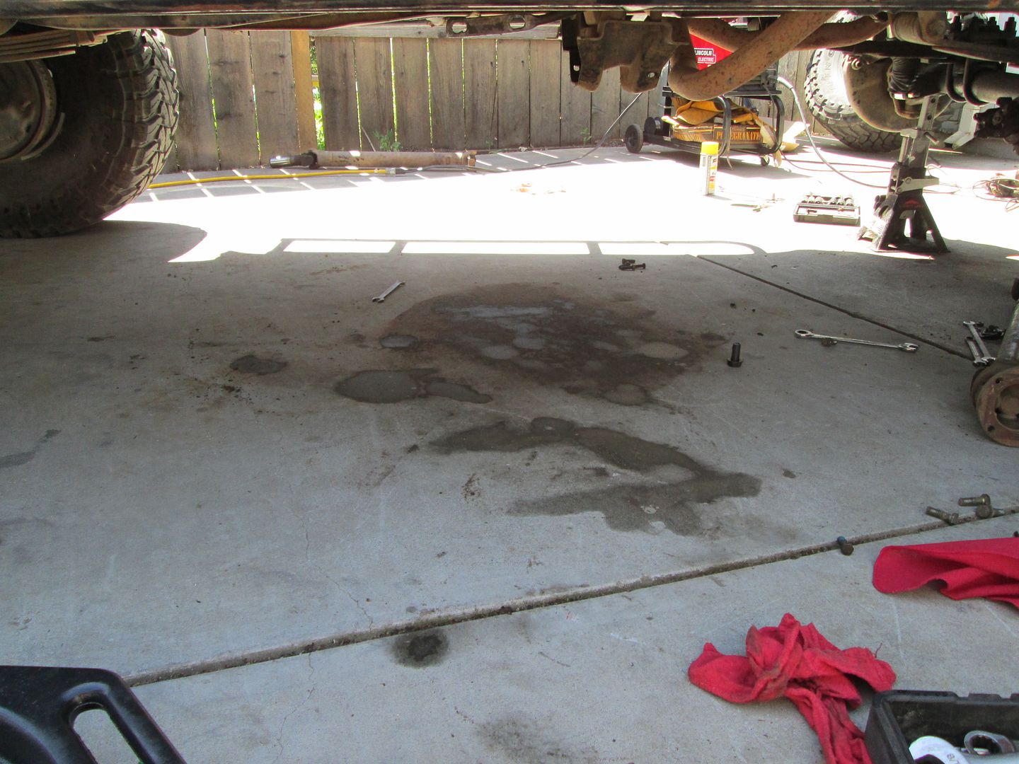

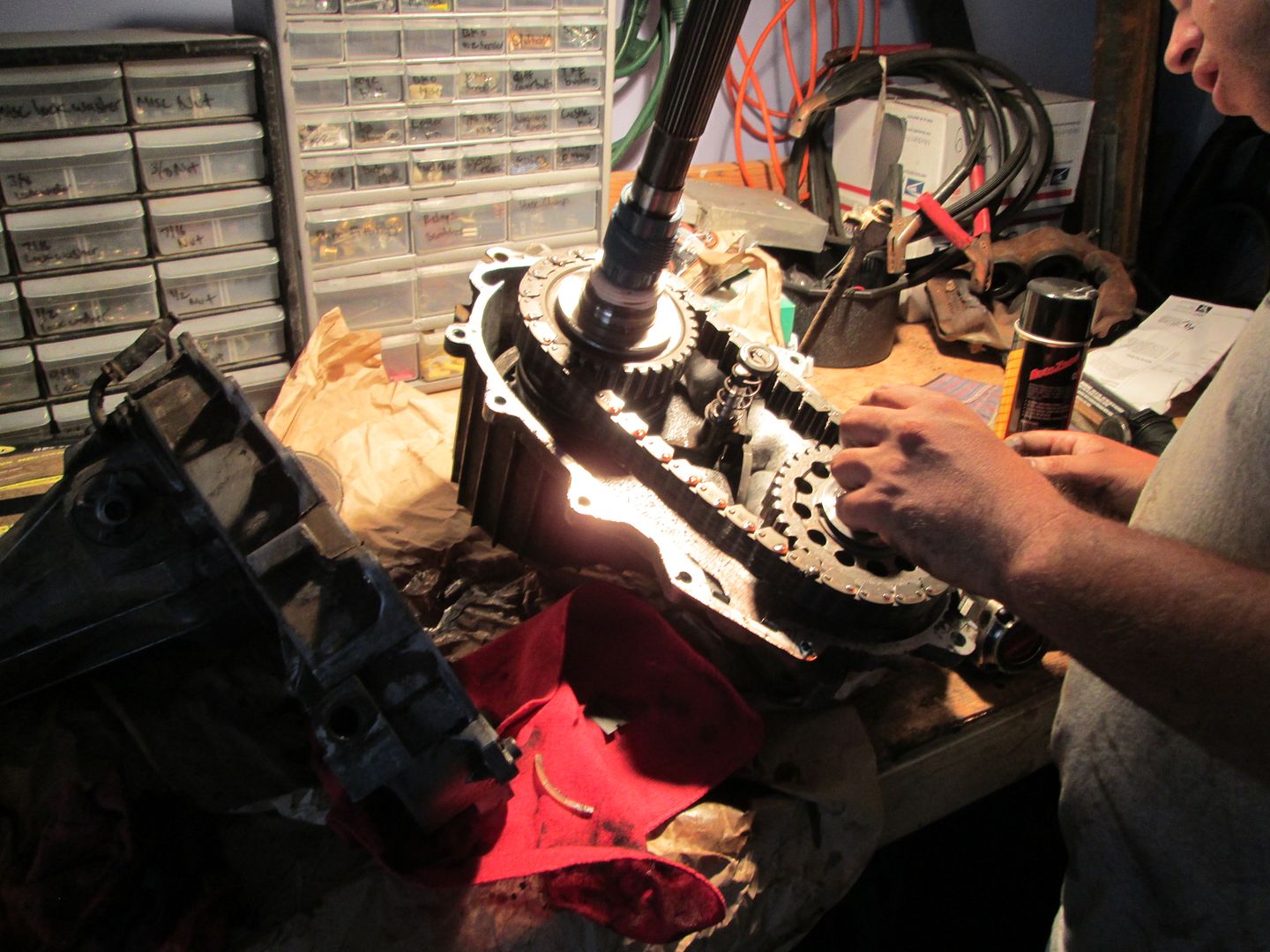

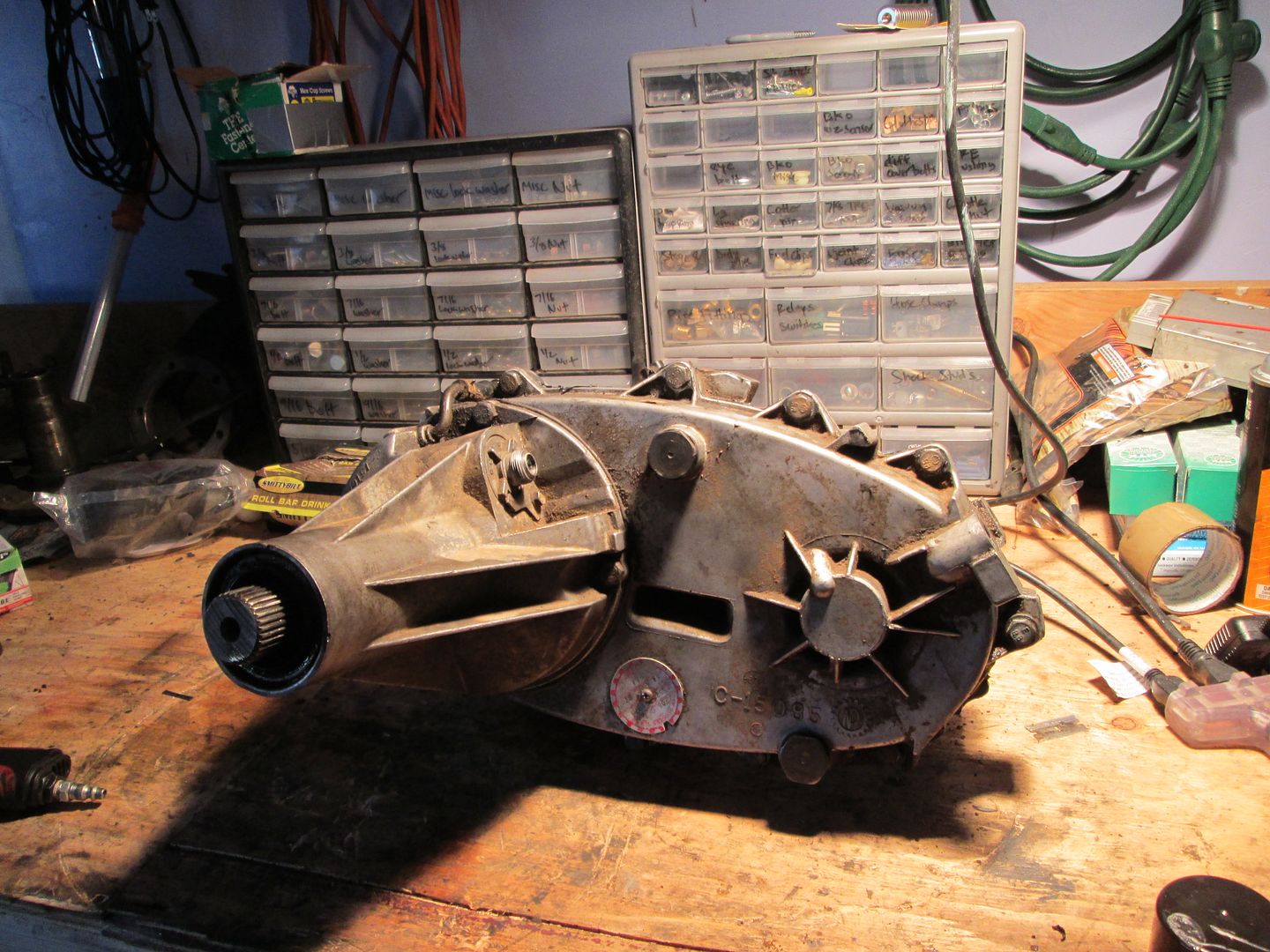

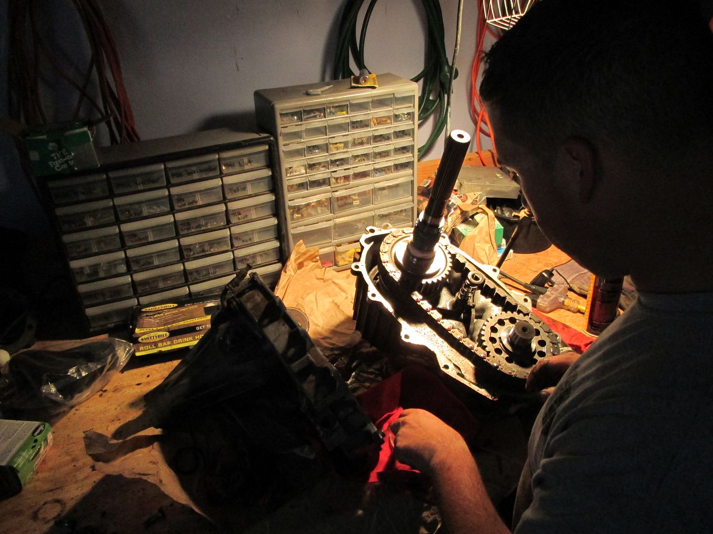

CJ started by having the truck piss ATF all over the driveway
CJ got the case out
Took it apart, cleaned the mating surface and applied a generous amount of RTV
Looks like a transfer case inside
Ready to go

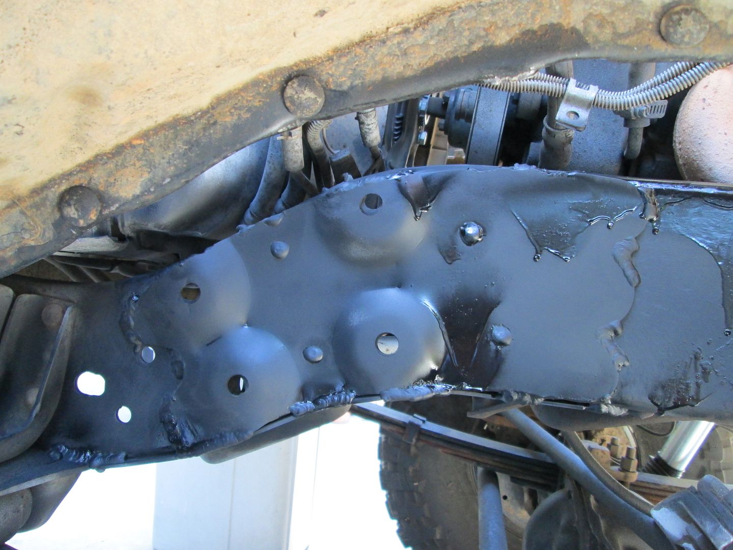

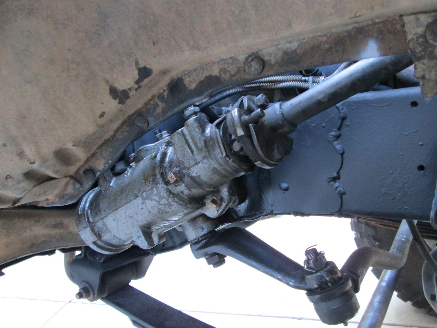

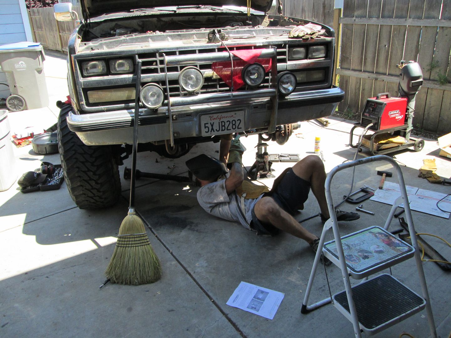

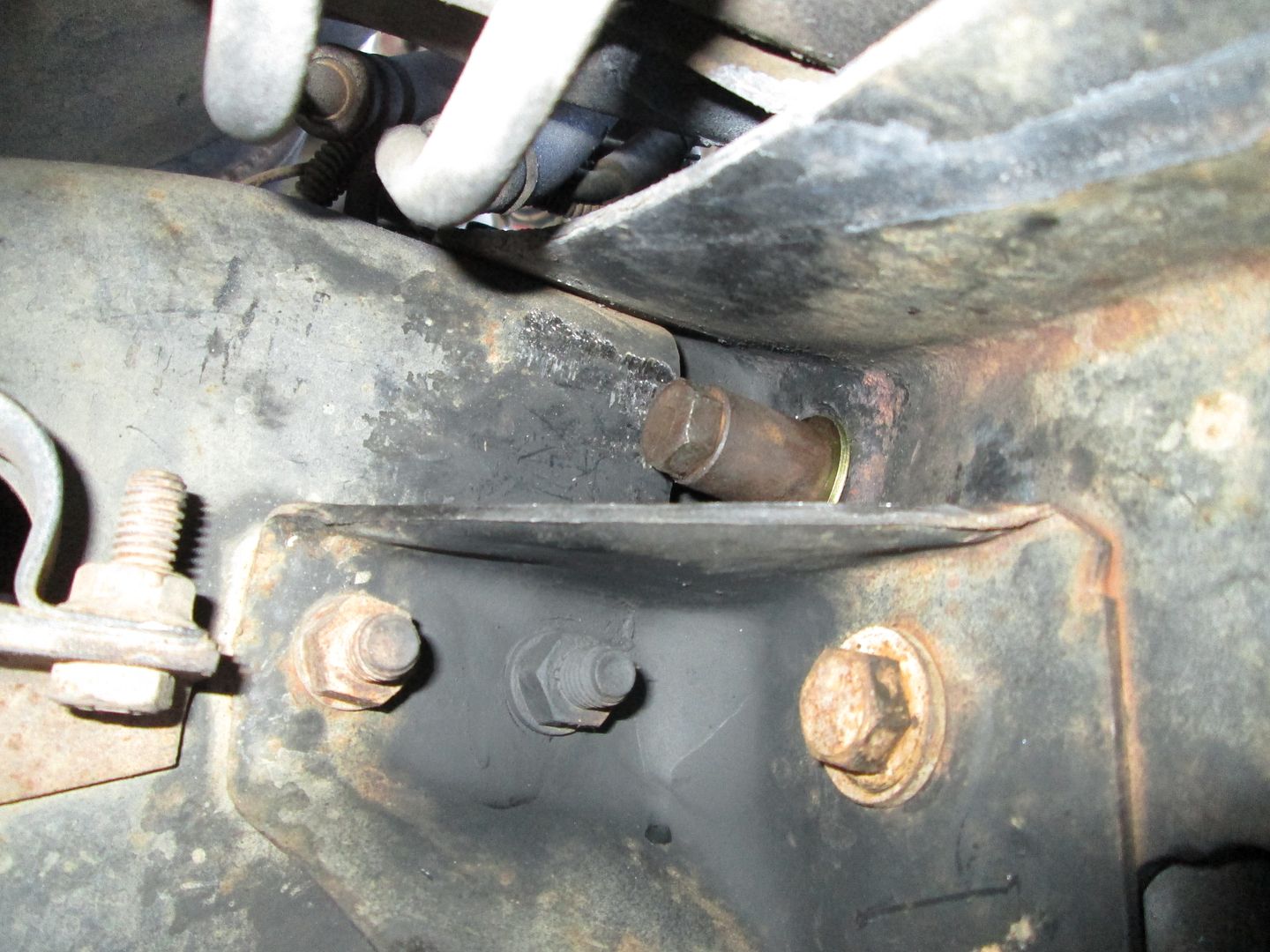

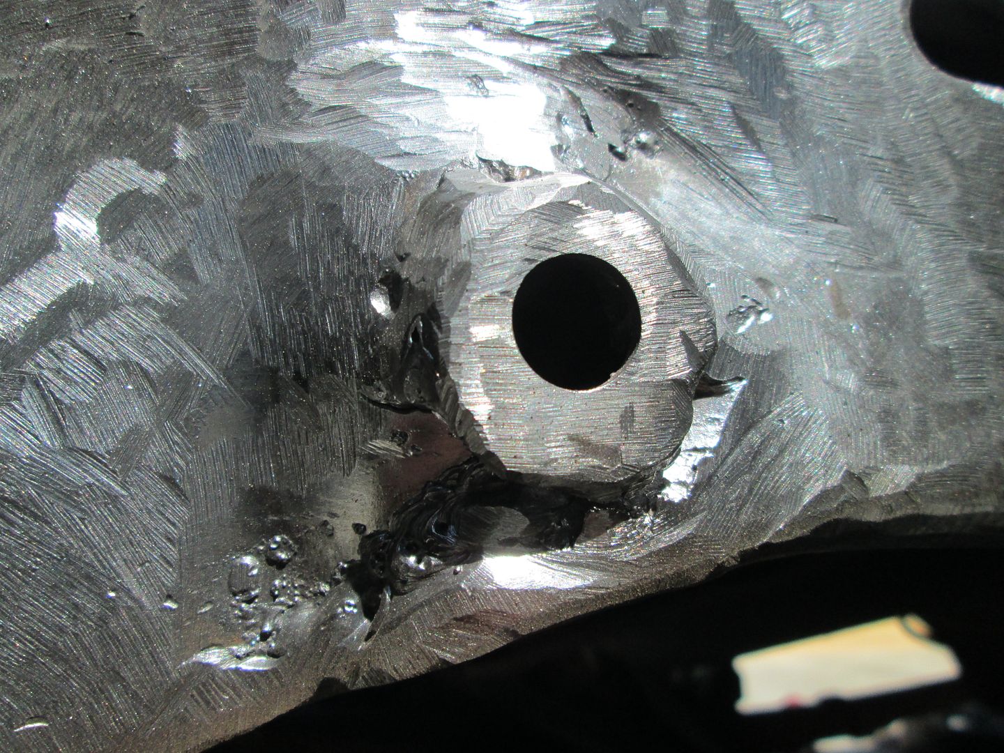

While CJ was transfercasing, I pulled the steering box and started by cleaning up the frame to see what we were working with

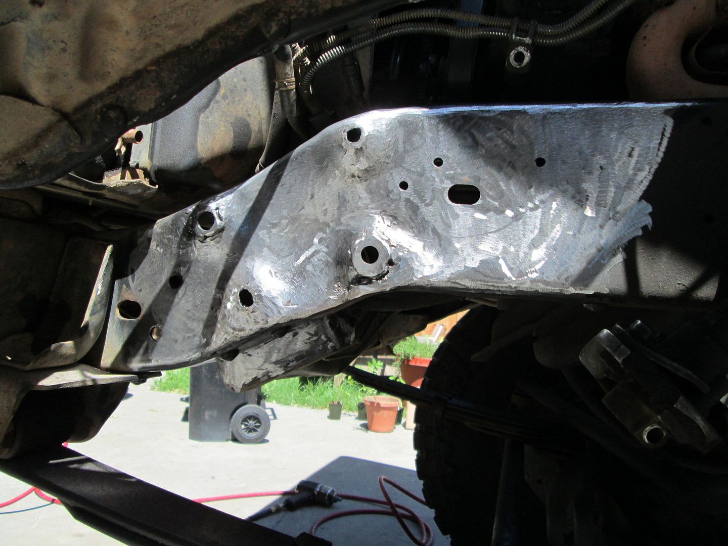

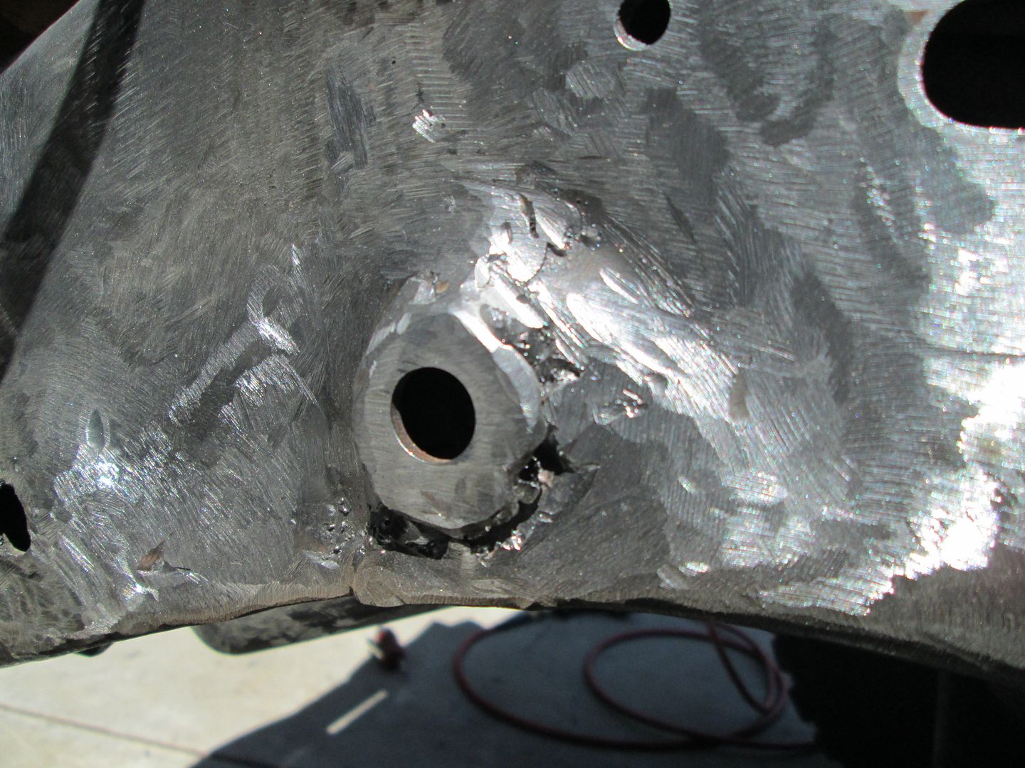

The trail repair, not bad at all considering it was done on the con

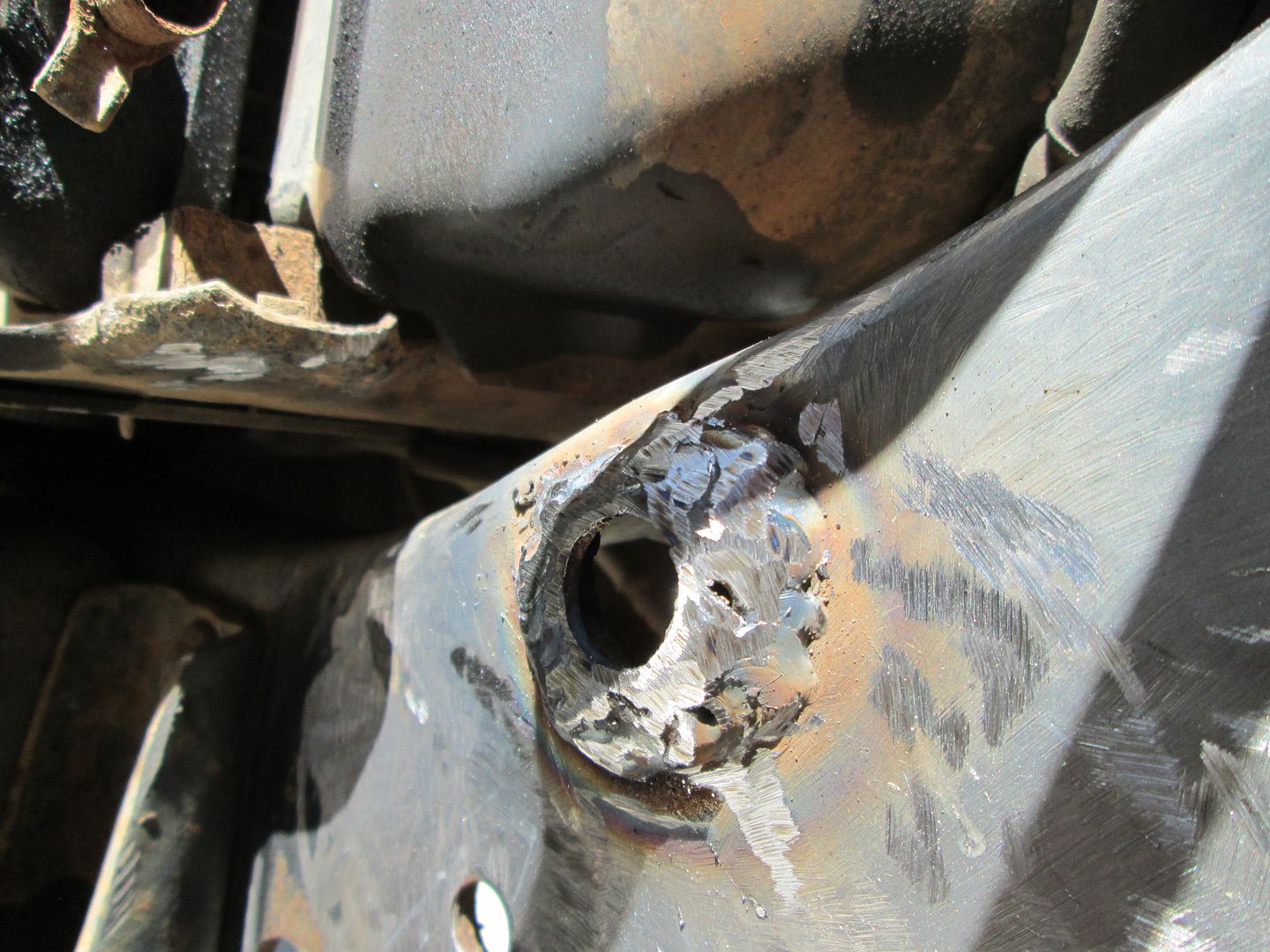

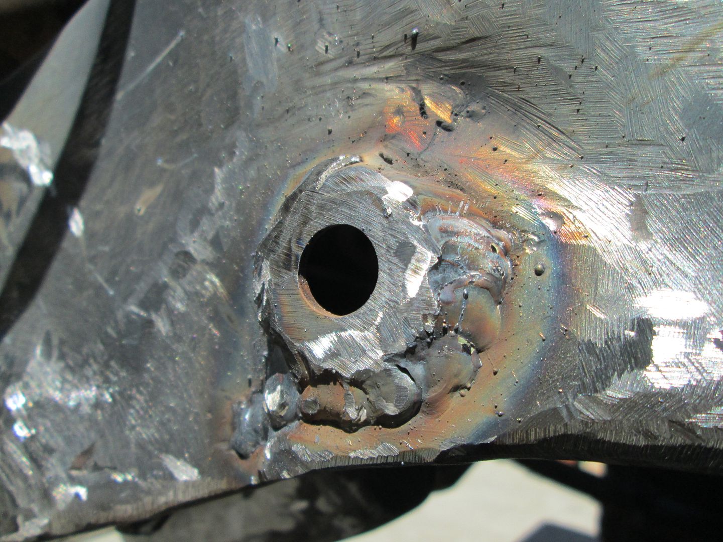

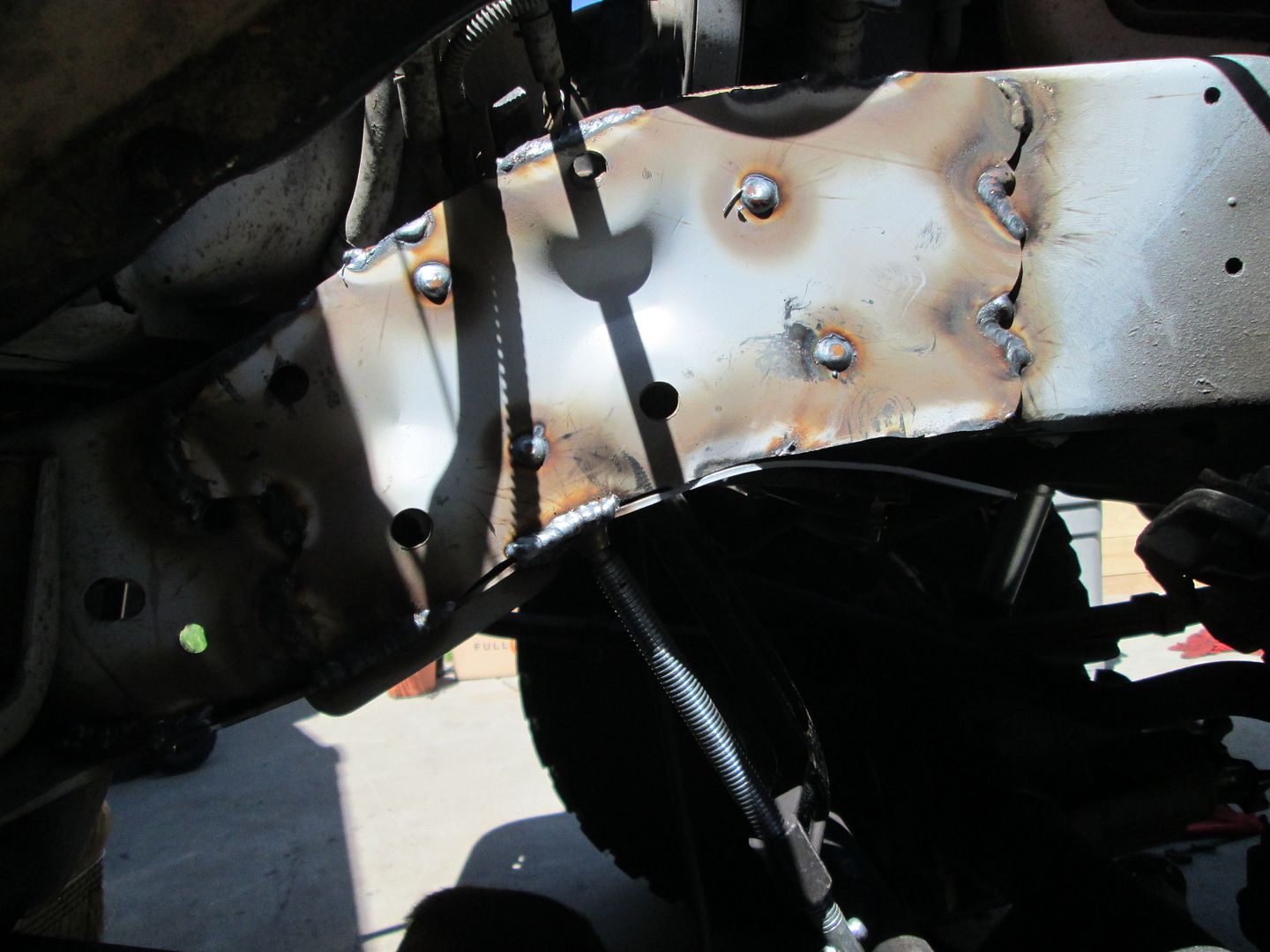

2 of 4 holes were in bad shape so I started by building up some weld around the trail repair to build a little more strength

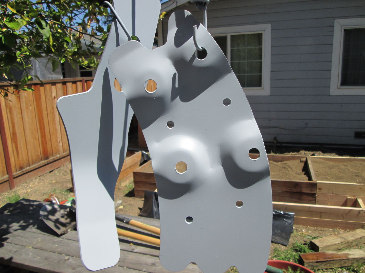

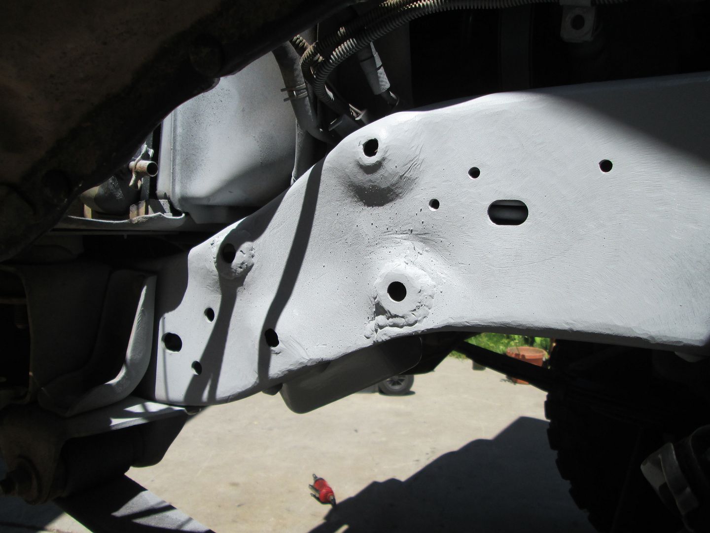

Then I hit the frame with a weld through primer to keep things rust free behind the new plate
Also primed the frame braces from the kit with some weld through primer
Action shot!
Welded up!

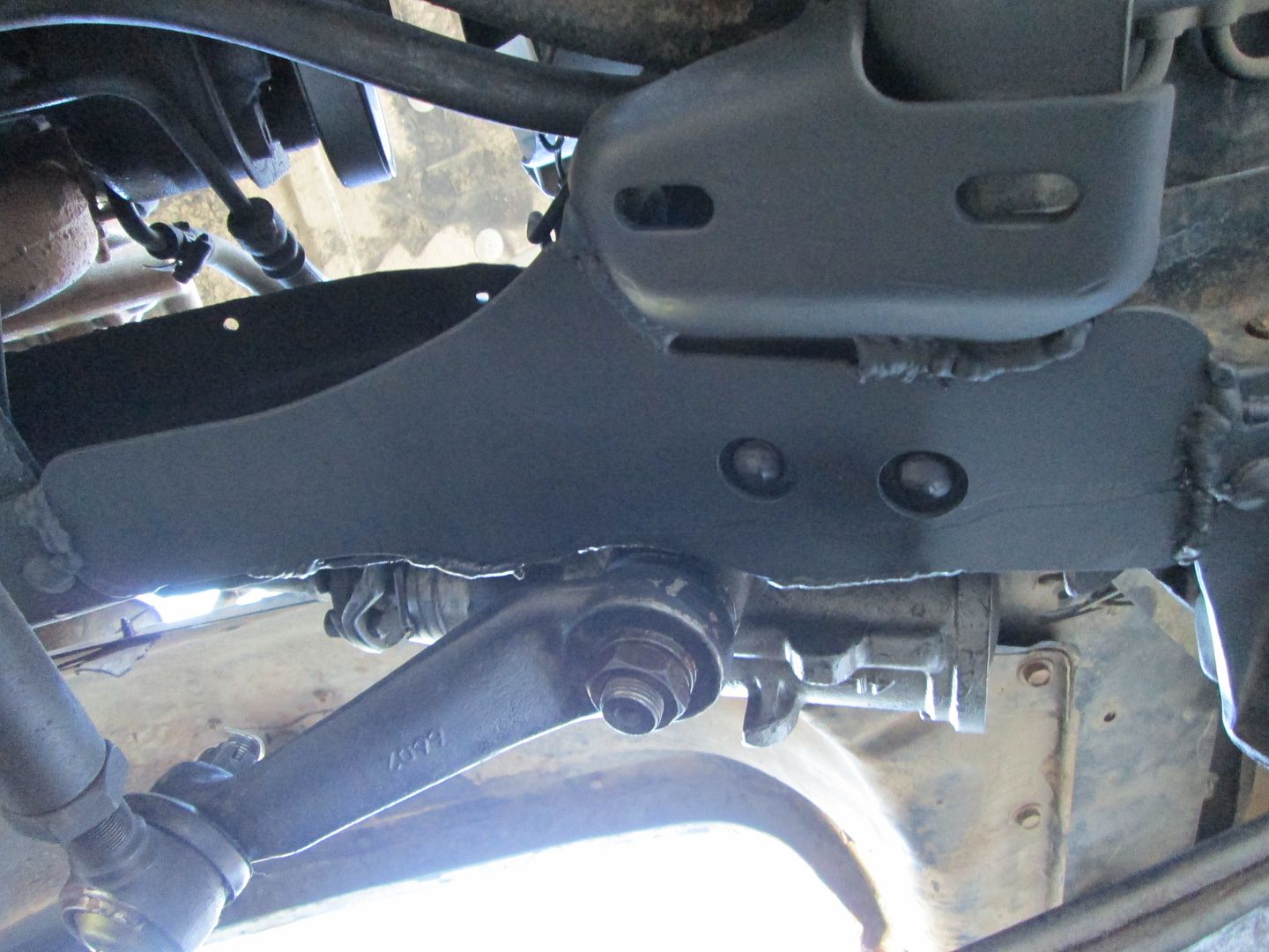

Painted and ready to go, CJ apparently likes to apply a single HEAVY coat :goodfinger:
From the bottom

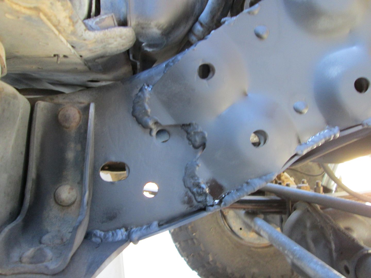

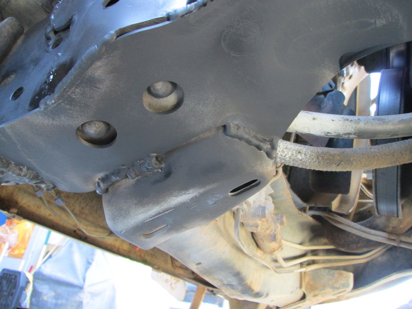

The bottom plate welds into this front crossmember which should bring a lot of strength into the whole thing
Front, note the gaps in the weld are intentional. The instructions specify where to weld, I assume the gaps are to allow for a little flex and prevent frame cracking

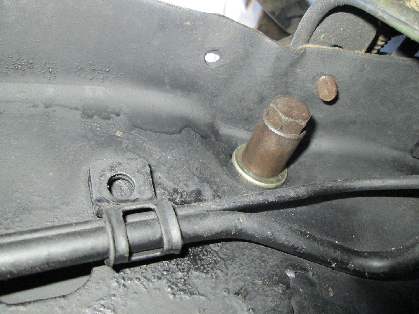

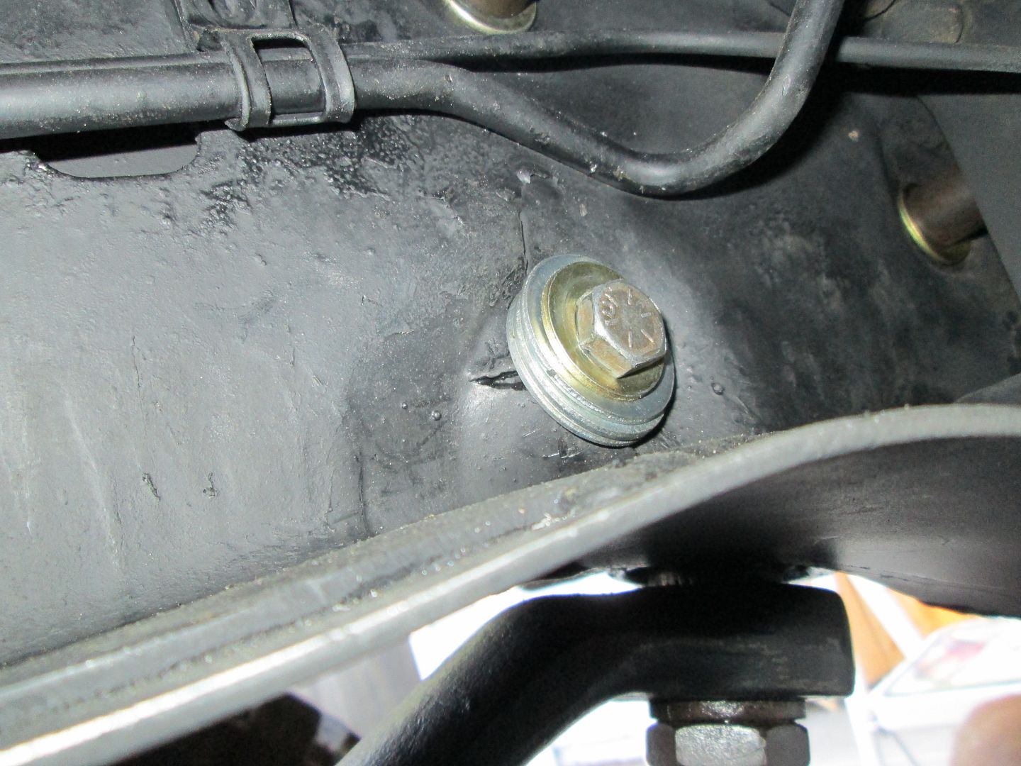

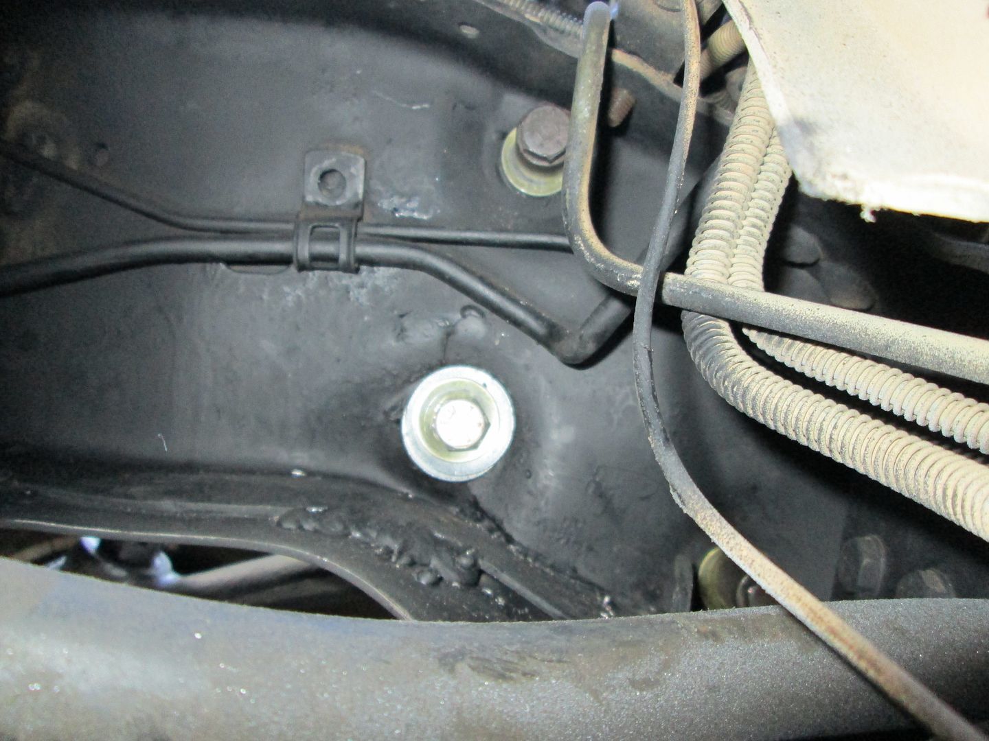

From the back side of the frame we stacked some thick grade 8 washers behind the factory spacer-thingys. The idea here was to spread the load out a little more and prevent future issues.

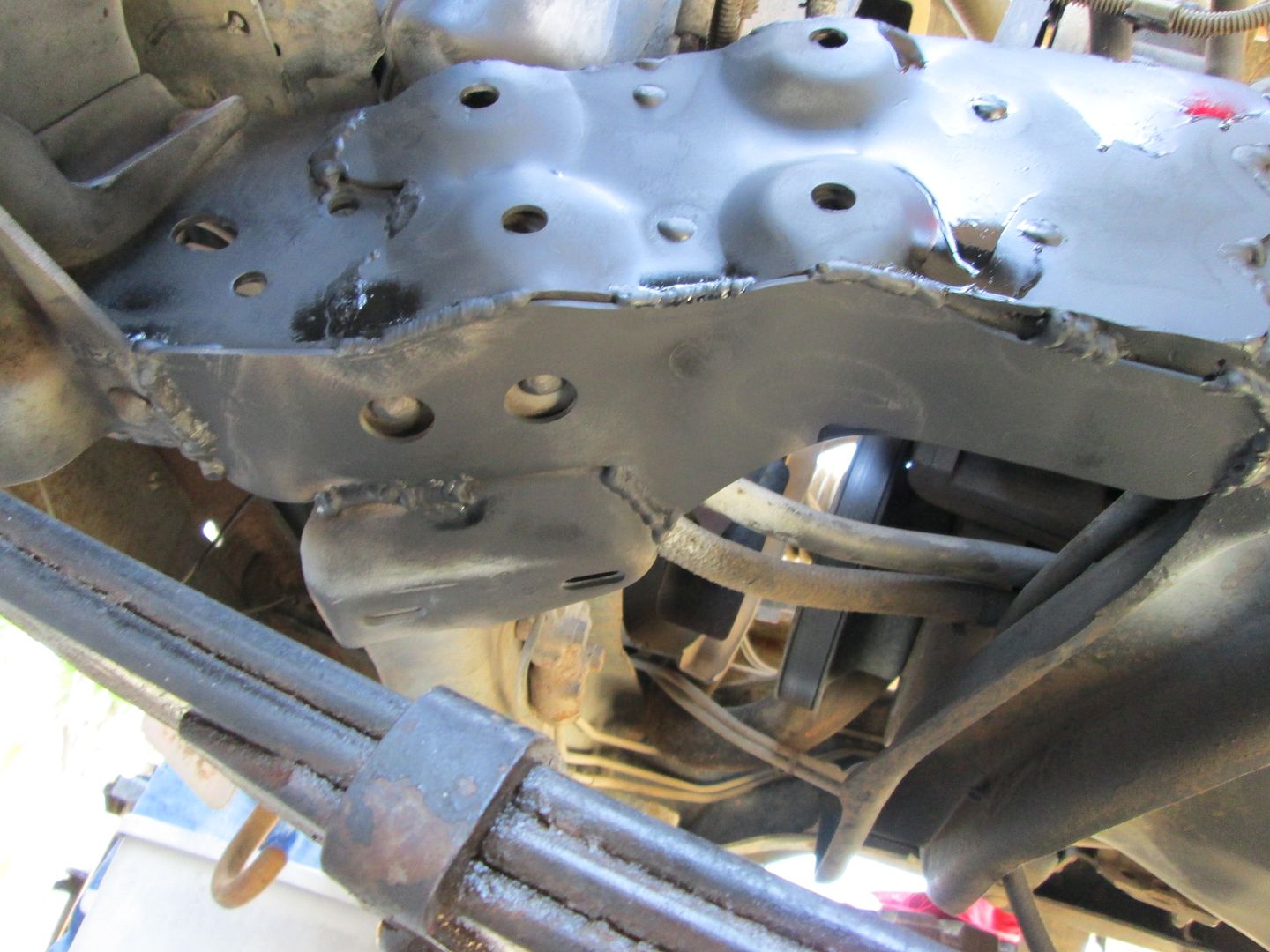

This lower left bolt was the worst one. The frame was a little tweaked and it was nearly impossible to weld it from the back side so we stacked a bunch of big thick washers to spread the load out and hopefully keep things together!.
Backside of the frame
Chevy makes all the bolts real easy to get to
Bottom shot
Box in and ready to go!
