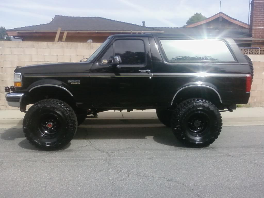

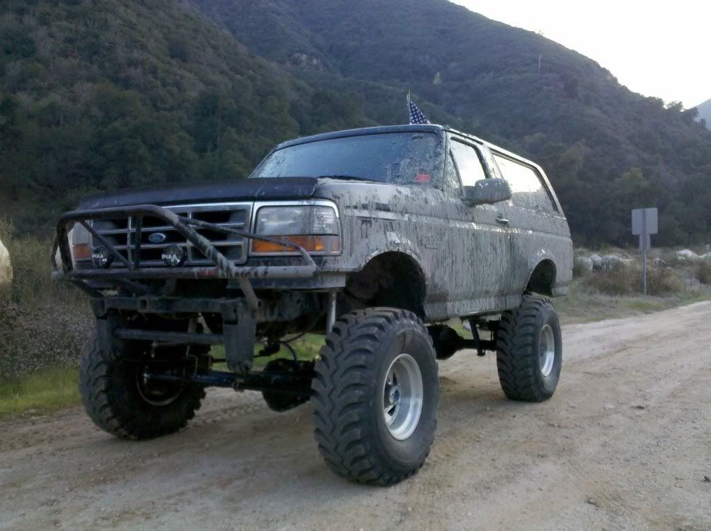

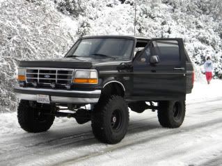

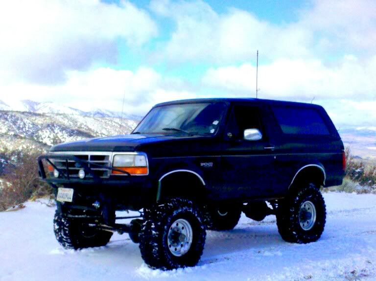

Hey everybody
94' Bronco Eddie Bauer
5.8 with Gibson Headers, MSD cap, rotor and coil, Ford 9mm wires, Jet Chip and k&n drop in.
e4od with 4R100 internals and a transgo stage II shift kit.
Dana60 high pinion king pin front with 4.88's and a Powerloc sitting under super duty X code springs
Sterling 10.25 rear with 4.88's and a Detroit sitting under F250 springs
37x13.50x16 Cooper Discoverer STT's on Factory Alcoa's
Cobra CB
front tube bumper.
Family cage.
Rear sliding windows.
Lariat 40/20/40 seat and I'm sure a few things I'm forgetting.

Great looking bronco. Sounds a good solid build too. How do you like the 4.88s on the highway?

4.88's and 37's run just like stock. I'm at about 2300 @ 70 mph

Nice looking Bronco with a good parts list. You run into clearance issues with those front spring hangers hanging down so low? I assume you had to do that to get the pinion angle and caster to work out?

No problems, it's all in the line you choose.
